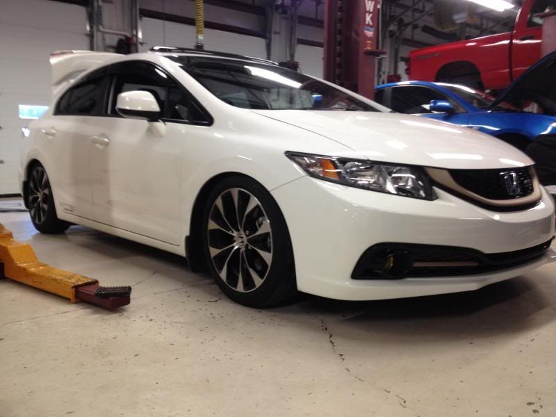

I have bc coilovers on my car and they are amazing I've had no problems with em The pic i put up is when i just put em in and there at the lowest at the front ride quality they are really good and they have 32 way damping all way around View attachment 29533
@Musavir Nazir Thats as low as it will go? Doesnt seem that its very low, comparing to others. Now that has me questioning maybe going with d2s?
i should have taken the pic when they settled lol i took this pic as soon as i put my wheels back on. Heres a better pic the day later at a show only pic i could find and the front is like half an inch from the rim and the rims are wrapped in a 45 tire so once i get my new tires it ill be even lower
