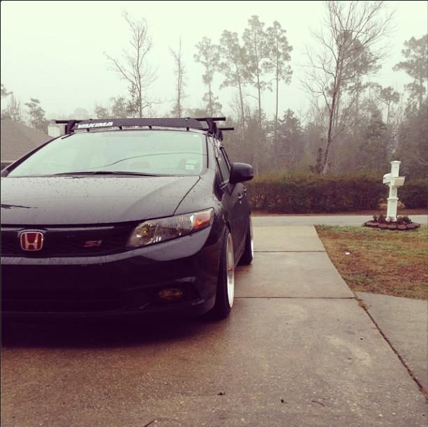

Flush with minimal camber I would go with 17x9 +35.
I ran 17x9 +22 and it wasn't flush it was more poke. If I were to do it over again I would have gone with the +35s.
Assuming you were talking about the Varrstoen ES7's and not the Advan SA3R, this gives you an idea of the 17x9 +22 on a 215/40 tire.
