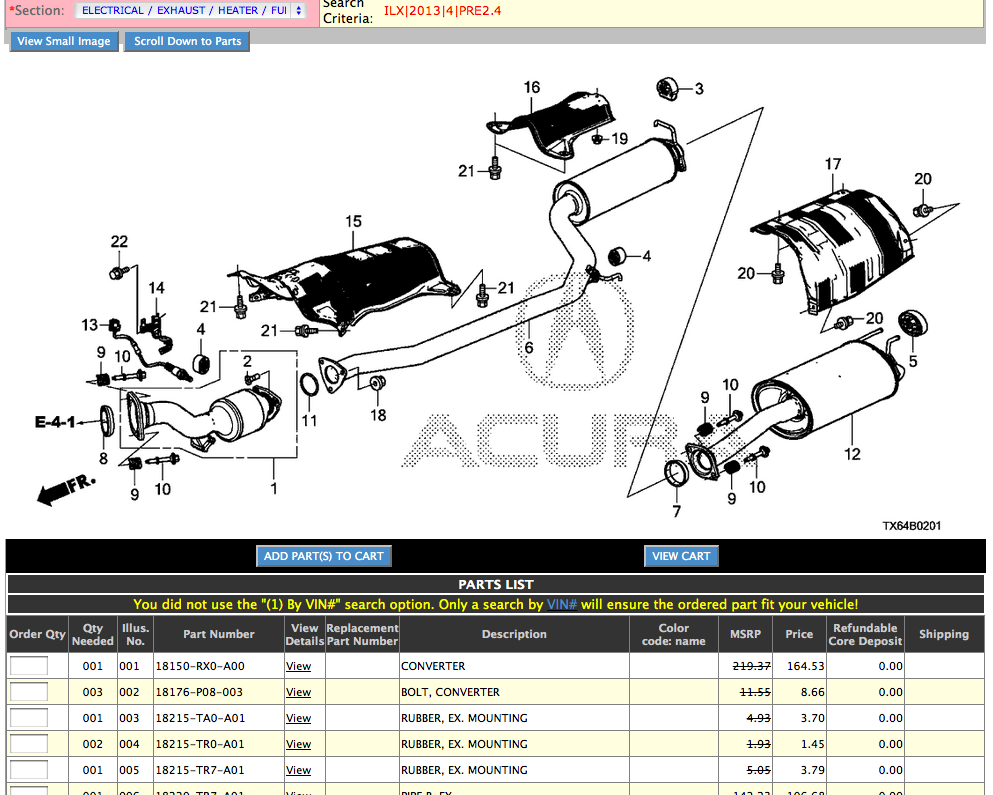

here is the 2.4 ILX parts list I'm seeing for the exhaust

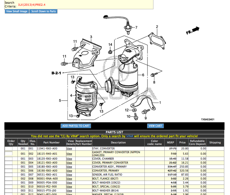

my bad, I thought that was for the ILX, not TSX. I dug deeper and found this - compare the tsx to the ilx
18190-r40-a00 (tsx converter)
part not found on honda's site
18190-rx0-a00 (ilx converter)
still unable to find a parts diagram like this for the Si
ILX - this would be the precat

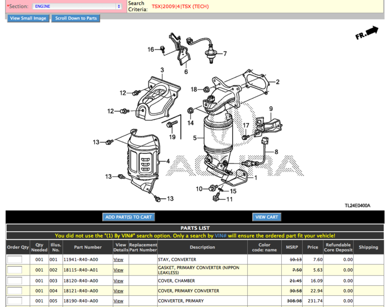

09 tsx precat below

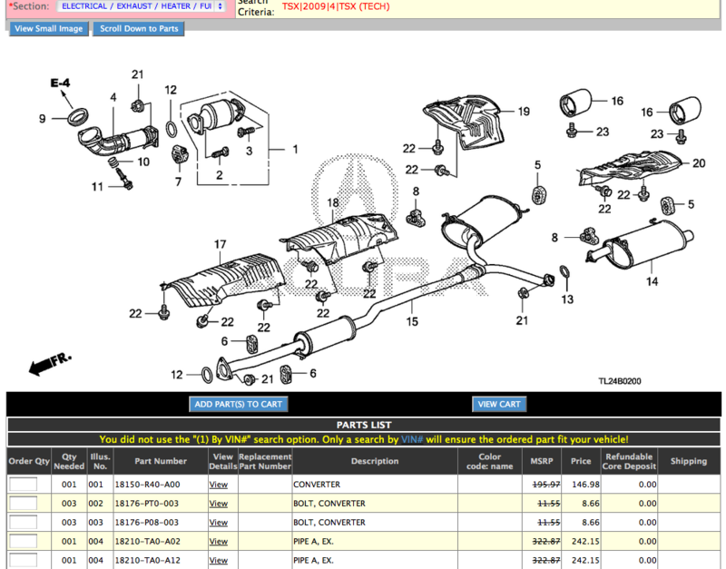

full 09 tsx exhaust
Ive looked under my car.. lol I don't see a 2nd Cat.. But our car has 2? Where the hell is it lol

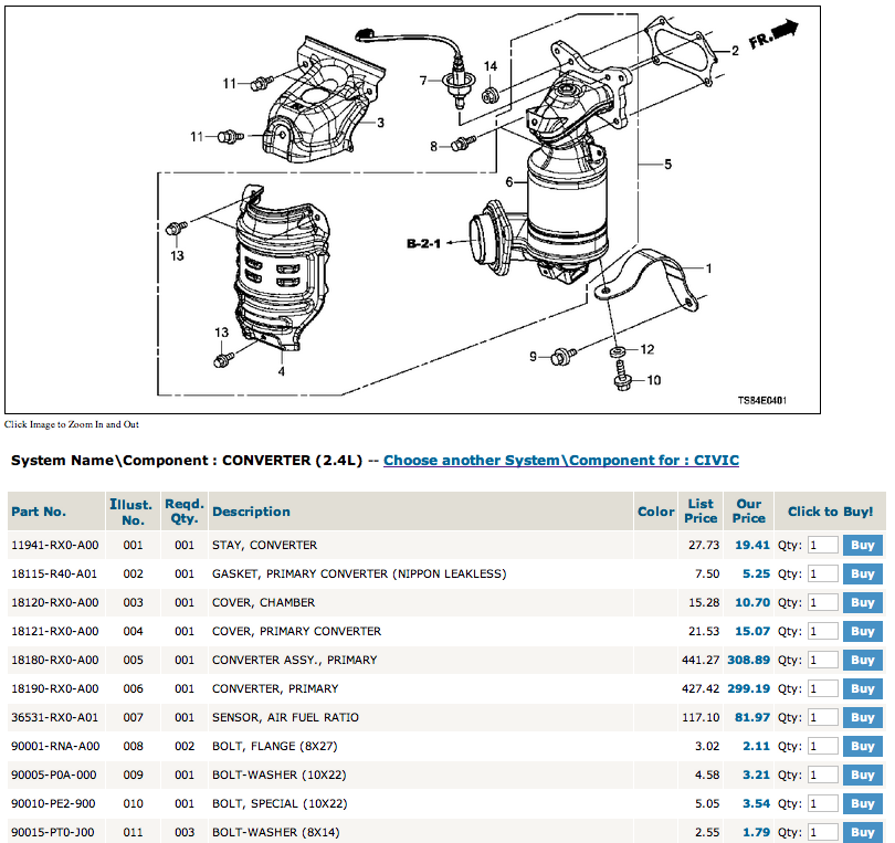

the precat (I guess it's called) is basically right off the head of the engine. So this 1st pic below - #5 would be attaching to the integrated exhaust manifold on the head of the engine.
and then this is their part that they're replacing that with... (close to the same orientation as the diagram above)
