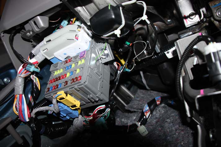

someone complaining about radio/heat controls with no lights -
I had the same issue, but there was a fuse that was blown. Try checking out Fuse #14 (7.5 A) in the interior fuse box. This one seems to control all dash lights pertaining to stereo controls/heating/ac etc..
kk
NOTE _ that fuse # is from the 8th. I do not know what fuse # controls the interior functions on the 9th - it could be the same though. If the fuse popped for some reason, it'd just need swapped out.

correct - if you're in the drivers seat - below and to the left of the steering wheel. Hang your head down where your feet go on the driver side and look up
