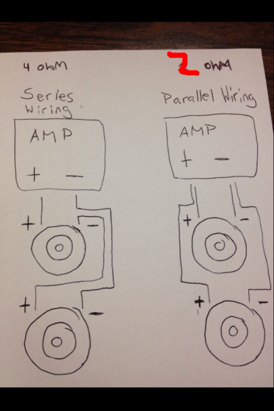

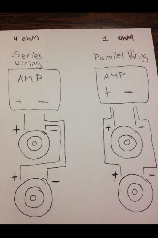

the pic on the right is how your wired now which i think might be to much for your subs since they are single voice coil ...i think your subs are letting you know that they cant handle that low of independence .
1&2 ohm setups are usually for DVC subs so the left pic might be the way to go for your subs hope that helps.
unless this chart is wrong, it says for 2 single voice coil subs at 4Ω running in parallel.... it'd be 2Ω... not 1Ω as your drawing states?
havent had my morning JOE yet my brain is a little slow still lol
