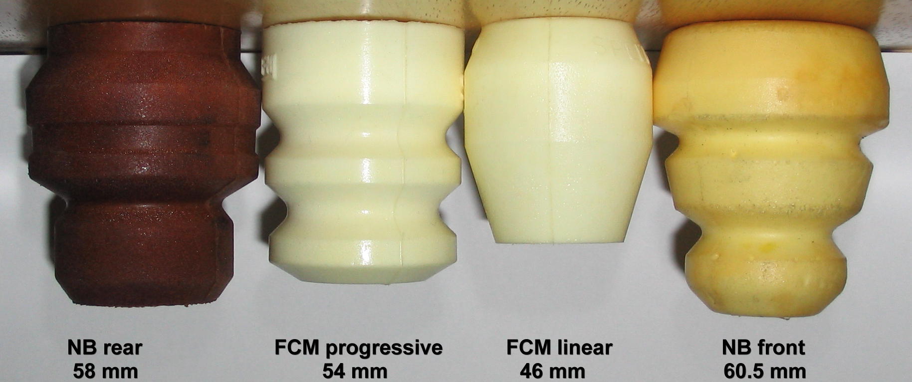

Oh duh. You are fine. Don't trim them. They are MCU elastomers. It's a very cheap type of foam spring. They use them in bicycle suspension forks all the time.
It is an inexpensive, lightweight, zero maintenance, long lasting spring. They are an active part of the suspension. Nothing to worry about unless they start to bind up on the strut from wear. That takes a long time.
I was a little confused on what part you were talking about in the other thread.
As far as the koni bump-rubber replacements... you probably don't want to start messing with those unless you really really understand spring rates and corner weighting in your car and have a very very purpose built and tuned suspension where those minor changes will have a measurable effect.
Don't trim them or you will possibly allow the strut to have metal/metal contact and that could mean serious damage. Riding on the MCU is fine. It's not really a bumpstop the way they used to be. Sorry about my confusion which delayed my answer... ugh I feel like I just had trouble trying a pair of velcro shoes.

Here is a pic of some different durometer (hard/stiffness) and length MCU "bumpstops" people swap into their suspension to fine tune it.

Yes, the best way to go about this is to buy new shorter ones. Cutting will compromise the integrity and durability.
However, the gains might be minimal, as i have noted prior , and as stated in the quote above. As you will essentially drop the car more and lose travel once more. Unless you buy a really short bump or really cut one half or more. Or, buy shocks that have more travel/longe; or not lower your car...... And if you cut a whole lot or buy a really short one; when you bottom out or coil bind you will be in for some discomfort. Bottom line is the need for measuring what you need to do.
Funny how some spring manufacturers with similar spring rates and amount of drop tell you to cut and some don't. Wouldnt it apply all around? At least Eibach has sense enough to supply new "bump stops" with their sport lines. :banghead:
