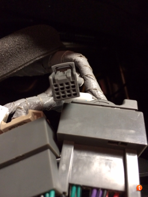

I recently purchased one of those cheap ebay head units that are specific for my 2012 Civic. It is designed to plug right in to the factory wires without a harness. I hooked it all up and everything worked, except I could not get the sound to work for the life of me. I triple checked to make sure everything was hooked up but still nothing. I have the premium audio system if that helps...

So pin 16 on the harness diagram...it says sub. Does it have a wire in that spot coming out of the harness? Blank? They want you to tap the oem sub in there?
That entire VTR plug outputs RCA cables, the ones in picture #4. I think thats what they want me to tap into
Also, another question, I have sub woofer that I just bought. So if I just unhook the stock one and wire up the new one should everything just work? I do not understand how just plugging in the stock sub will make all the other speakers work.
I'm referring to the last pic posted "vtr" #16. Which looks like the pinout/harness in your 3rd pic. You'd look to see if pin 16 has a wire coming out, or if it's blank. 2nd row, 4th from the left.
Well here's the problem. No connector for this.

I hate to say it, but with some of these chinese kits, i might suggest that you check the continuity of each wire before continuing. More than a handful of times i've gotten stuff that makes such a poor connection in the wiring/harness that it causes issues or maybe in your case, non-functioning :P
Maybe need to trigger the amp turn on wire. I'd honestly like to see it before going into more detail. I don't want something bad to happen like blowing the speakers/head unit/ fuses.
Alright, so today I tried using the subwoofer connector from the metra harness and also tried triggering the amp with the AMP CONT wire. Neither worked. Although, the triggering of the amp wire made the Power off display on the I mid. I guess the next step would be taking the other part of the metra harness and manually wiring all the rest. I'll probably take it to an audio shop for that.
