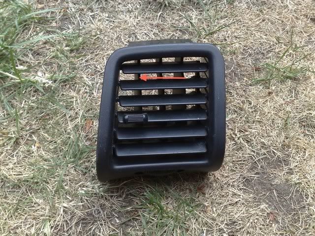

not a 2012 vent but i used this to show where mine rattles:

I noticed this on my 2012 coupe and did some more investigating. It appears to happen only after the A/C has been running for a while, probably why the dealer doesn't hear it when taken in to complain. Mine will rattle/veins wiggle at any fan speed setting when the vents have cooled off enough from A/C running. After the car sits in the sun not running for a bit, they tighten up and are quiet. I think what is going on is the plastic shrinks when the vent material is cold, the clearance between the individual veins and the side angle adjuster becomes loose letting them rattle. Maybe some sort of flexible sealer type stuff applied in the right places would stop this? Otherwise my car is totally silent so this is a bit irritating.
I find mine only does this when the louvers are aimed straight ahead. If I adjust them to one side a bit they tighten back up and stop shaking.
