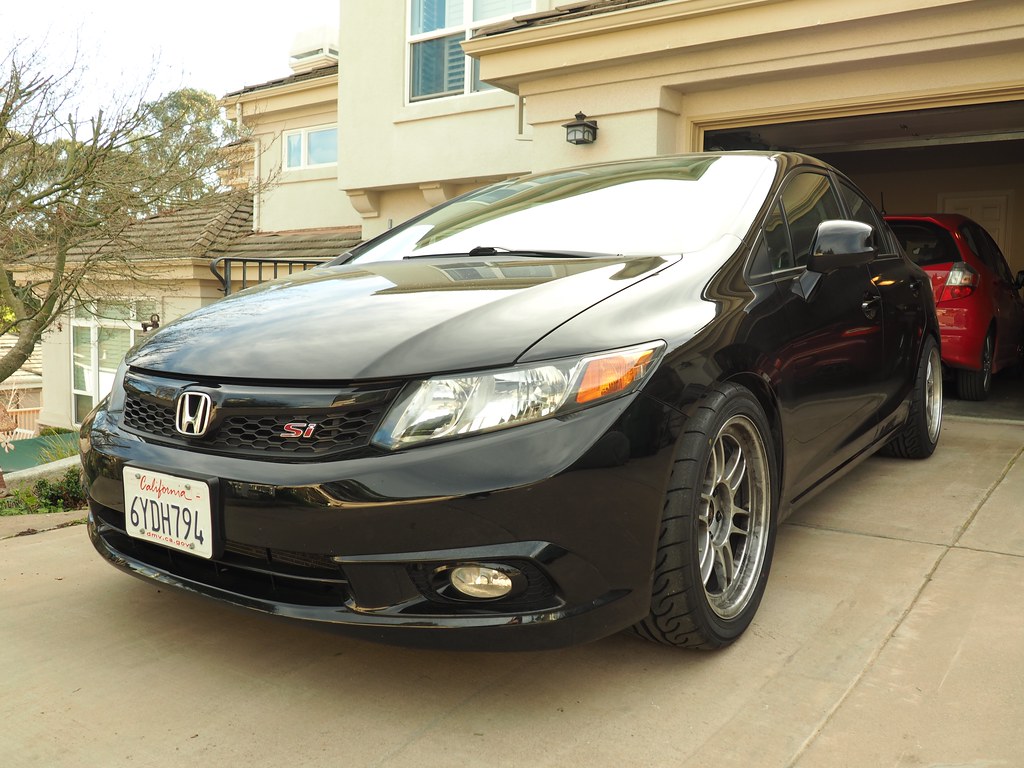

I made a thread about these, they are 17X8.5 offset 30. I can't find a but one person on the web that has these and the guy is not on any forum from what I can tell. I like the meaty look but I do not want to do a ton of modding to get these to work and def do not want to run a super skinny tire.
I think these would be hot with a set of pro-kit springs on my modern steel metallic Si.
Those would look good, do iiiit. 235/40 or 225/45 on those bad boys

You are correct with the sizing and the reasoning behind it. The fender liner has been trimmed and the fender itself has been rolled. It appears that I'll have to buy a lower offset pair for the front in order to dial in more camber as it barely clears the front strut with a +35.
