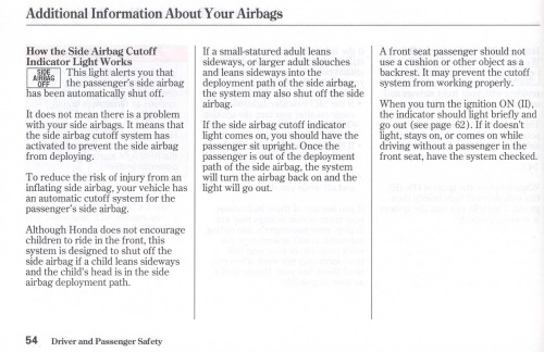

If the person moves in the direct path of the side airbag it will also do that. So, if you have the person lean towards the passenger window where the airbag would normally deploy, it will alert you. It won't deploy an airbag when the person in the seat leans into the path of deployment. If this isn't the case in your situation, take the car to honda and have it looked at.
Yes - full sized adults. Two honda vehicles I've had did it. If the person would be where the side airbag would come out of the seat, it would show an alert. I'd have to get my manual, but it talked about the light coming on when a passenger was in the path of the side airbags. It said in the event of an accident, it wouldn't deploy the airbag to avoid injury etc etc
i can sometimes trip the passenger airbag light if i put my arm on the headrest during a long drive
found this from a pilot forum - sorry it is so small, but describes what I was explaining
no problem. Again, I don't know that this is the problem the original person is having... but it at least gives them something to test. If it's not this, then they need to see honda.
K thanks. I think sometimes she doesn't sit upright she kinda slouches forward. Not really to the side but I hear that it's normal if the person isn't really heavy n leans to one side a bit. I think I'll have her sit in the back lol.
