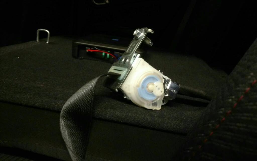

This is the problem causer

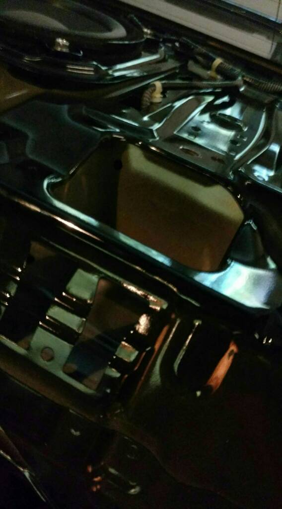

And this is where its mounted
Problem is now I can't get it to relax and let the seatbelt extend.
So I can't mount it back and I'm pretty sure it's illegal to remove seatbelts
What do I do?
