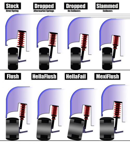

Thats camber.
Offset is where the wheel sits in the wheel well. The higher the number the closer the wheel moves towards the strut/engine/car. The lower the number the further the wheel moves out towards the fender.
Camber:

The offset just determines where the wheel sits in the wheel well. If you had a 17x7 wheel and the offset was +60 it would hit the strut on the inside. If the offset is +10 it would hit the fender. The higher the number the more the wheel sits closer in. The lower the number the further out the wheel gets.
Stock offset on the Civic is +45 so sticking around that number is good. The lower the offset the closer and more "flush" to the fender it looks. Most wheels in a +35 should not give you any issues. Beyond that you may have to run a lot of camber or roll the fenders to avoid rubbing. So anything between 45 and 35 is pretty safe. Hopefully that helps.
This is a jokey picture but it helps illustrate offset pretty well.
Consider the top set of pics to be a wheel with a +45 offset.
On the bottom its basically +35, +25, +15, and 0 offset
+35 +25 +15 +0
