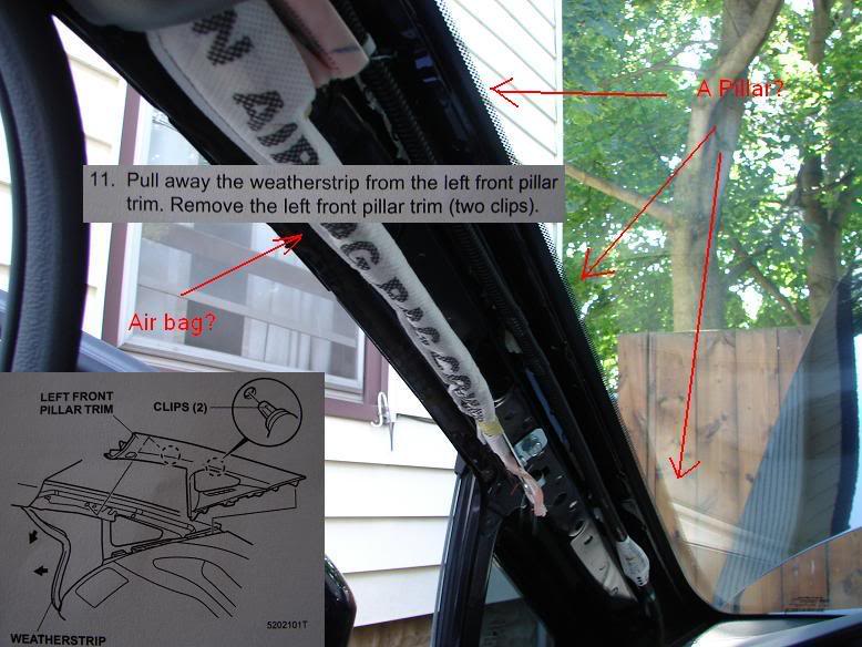

disregard the text - but you can see how it'll probably look on the 9th. This is an 8th
Nothing at all what I thought it would look like thanks for the info!
in my 8th gen i pulled the weather stripping out, ran the wires up through there from the dash, and tucked them into the top of the airbag cover then into the headliner
So u didn't acually remove the cover u just pulled the weather stripping out and ran it throw?
yup, theres a little channel you can tuck it into behind the weather strip
