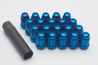

Well I just bought Gorilla lug nuts for my car:
Figure: Blue Gorilla Lugs
But I needed to buy Speedstar Taper Conversion washers because aftermarket lugs pretty much sit in a 60 degree angle and it is not ideal and not recommended for our stock wheels. The stock lug nuts have ball seats (or 45 degree seats).
Figure: aftermarket lug with 60 degree seat vs. ball seat lug
Figure: Conversion washer on aftermarket lug vs ball seat lug
You can get these from kseriesparts.com (used to be the ClubRSX parts store).
