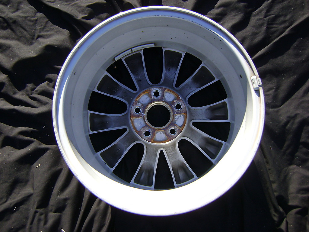

hi, do you know if these h&r spacers will fit my 2014 civic? All the specs seem to match up but Im worried the studs might be too long.

The h&r will fit. You need to make sure the back of your wheel has relief cuts in the event the oem studs stick past the spacer. What wheels do you have?

Oem touring rims

Can you take a picture of the back? Are they flat or are there indentations on the back of the hub?

they are on my car right now and I cant seem to find any pictures. However, looking at other oem honda rims around the same year, it looks like they have relief cuts.

Your talking about those holes right?
