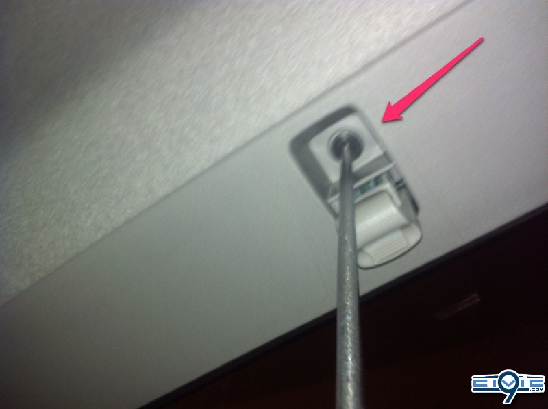

1. Remove screw behind stow-able hook.​

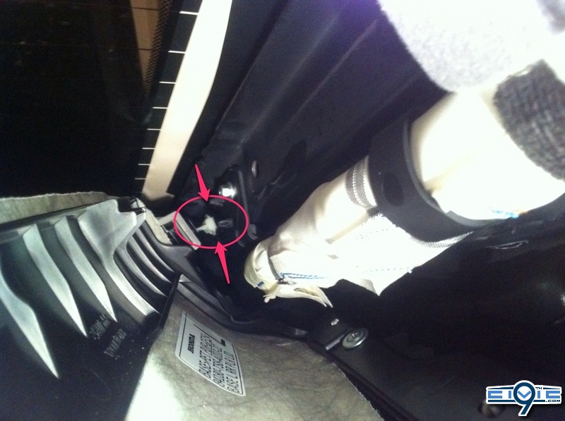

2. Insert flat blade screwdrivers behind plastic airbag badge, press firmly to release locking tabs and then pry the badge off​

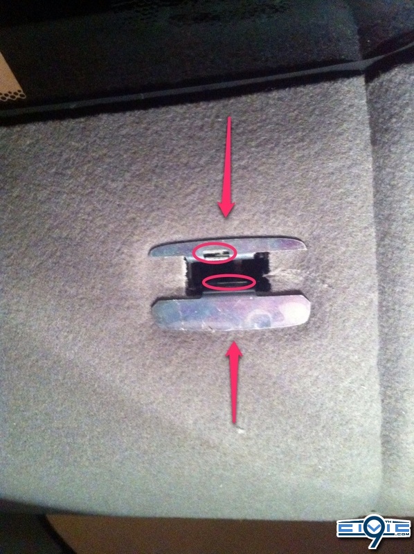

3. insert flat blade to release locking taps, then pinch the metal bracket and pull to remove.​
