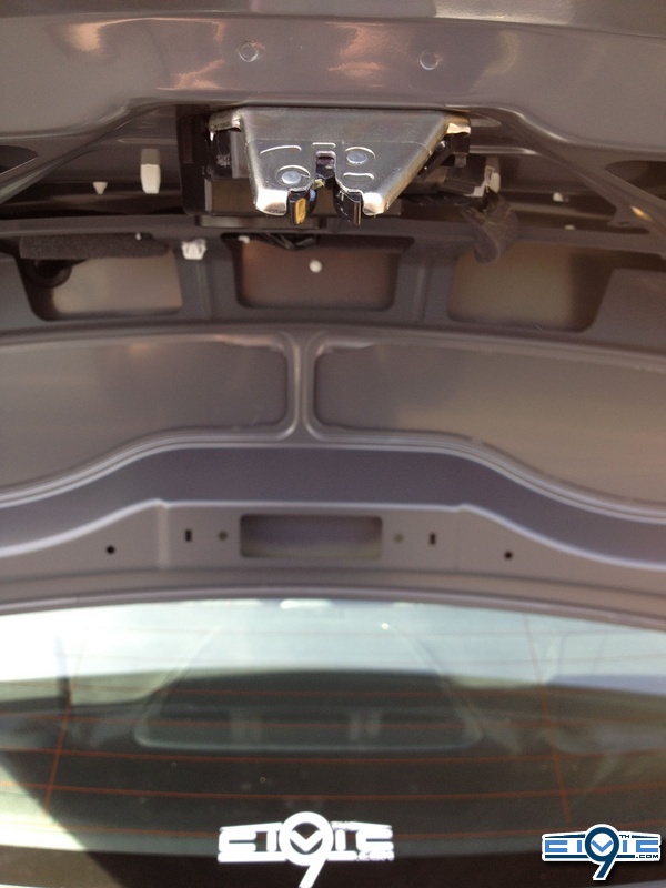

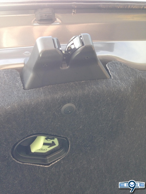

  1. Remove the existing trunk latch cover. There are a couple of hooks in the front of the cover and a release tab in the rear. Don't worry about ruining the existing cover since you will be installing a new one:

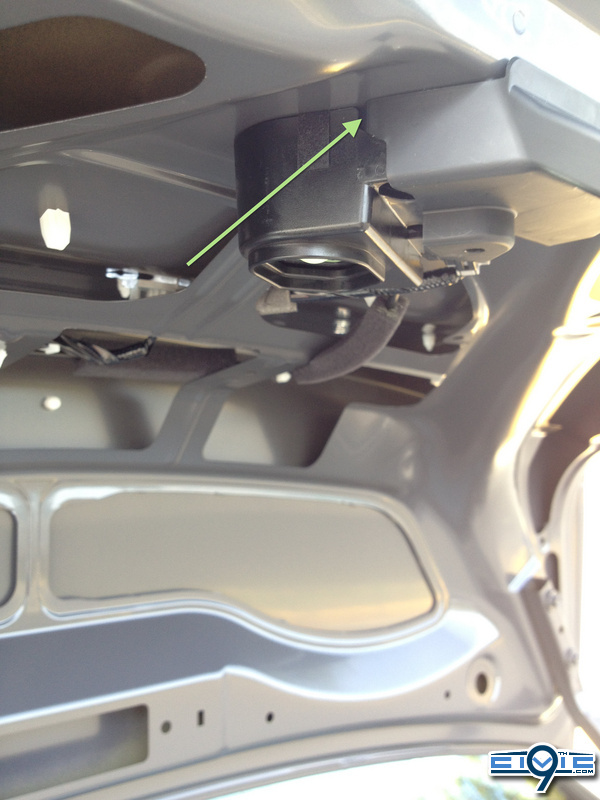

  2. Install the new trunk cover. It should slide in place easily, but make sure the left-hand hook inserts inside the latch instead of outside (highlighted with a light-green arrow in the photo below):

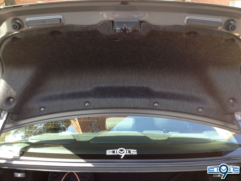

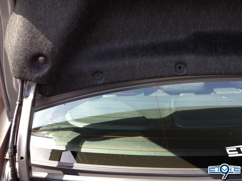

  3. Line up the insulator with the holes in the trunk and start installing the clips:

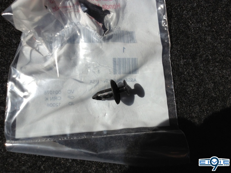

  4. There is one clip that is completely different from the rest:
    Install that clip in the middle of the insulator and screw it in with a screwdriver (shown below):
  5. That's it, you're done!
