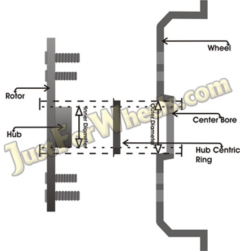

as for the hub bore, that refers the the size of the center hole on the back of the wheel. most aftermarket wheels are much bigger so they can fit all makes. you will use a hub ring to adapt the larger 73mm wheel to the 64mm hub. the wheel MUST have an equal or larger bore than the vehicle to fit.
here is a really good illustration of it
Ah great thank you. Good thing i asked here or i woulda been in a dilema when i ordered the wheels lol.
hubcentric rings are cheap. Most places that sell aftermarket wheels/tires will have them as well.
