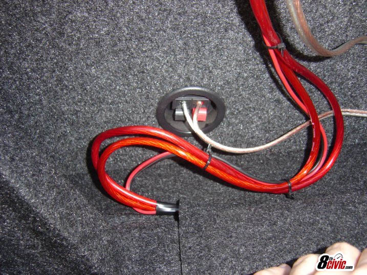

First, run the power
wire(I used this thread, very easy to do)
8th Generation Honda Civic Forum - View Single Post - How do I get Power to the Trunk?

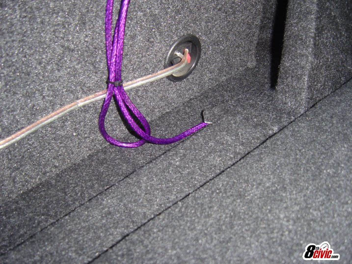

Then a remote wire...
I just removed the factory HU to get an ACC wire(use this thread)
http://www.8thcivic.com/forums/audio/37564-diy-aftermarket-radio-install-ex.html
then use a T-Tap on the Purple wire w/ silver stripe (This wire is also located somwhere in the fuse box, it might be easier...)

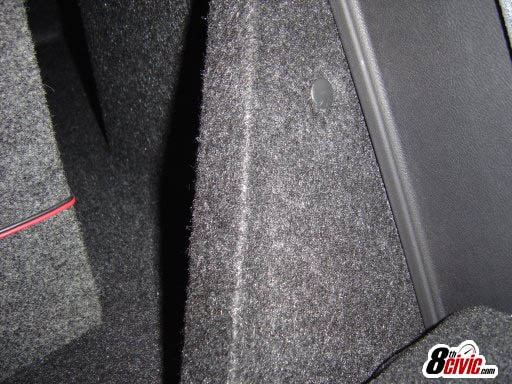

Last, the ground wire (Sorry this isn't a great pic)
On the driver side back seat, pull the carpeting up, and you will find a great point for ground, *hidden out of sight!*)
Just use a ring terminal and a Self Tapping Screw on the metal that lays beneath the carpet.

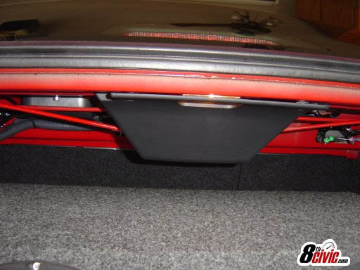

Pop the black plastic cover that shields the stock subwoofer off
it's on there fairly good, give it a good tug downwards...

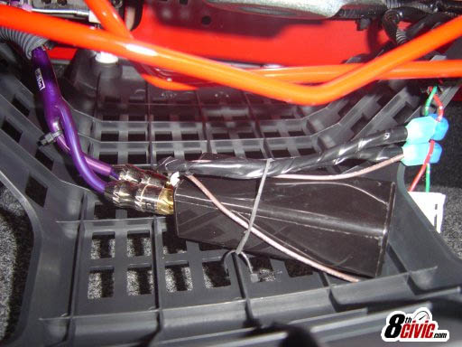

On the LOC you will see wires on one side, and a RCA Connection on the other. Twist all Positive wires together, and all negatives wires together.
I then used electrical tape, to hide the wires, and keep them together.
Now, place the male plug connector on each of the twisted wires...you should only have 2 plugs.

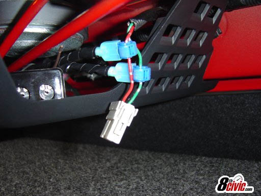

Disengage the factory subwoofer by pulling the clip out. With a T-Tap, tap green for positive, red for negative, and plug in the LOC to the factory wiring.
Then, I zip tied the the LOC To the Black Covering...
Now, plug the RCA Cable into the LOC.

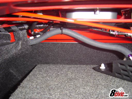

I then used some Black Tubing to hide the appearance of an RCA Cable, and ran it along the top of the trunk, with the factory wiring, using zip ties to secure it

Place the black Cover back up on the top of the trunk. Tuck any exposed wires inside the cover. You shouldn't see anything when finished!

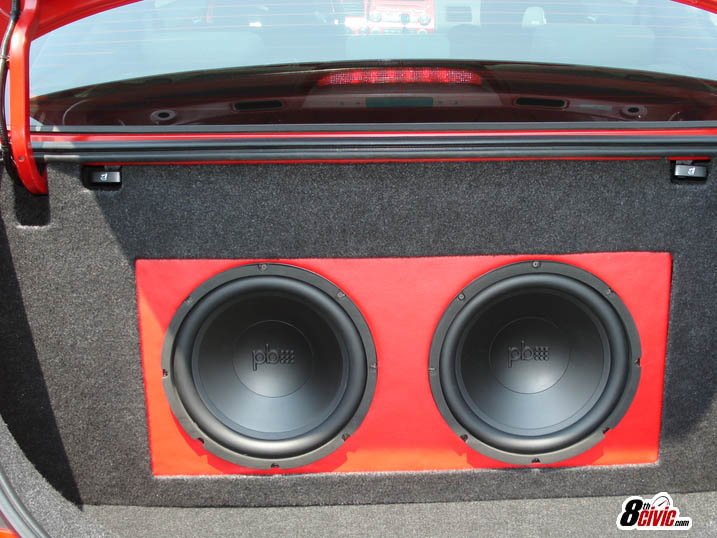

I then mounted my amp to the top of the Subwoofer Box.
Plugged everything up! You're Done.
Completely Clean, Factory Looking Install...

Wow, forgot I posted this. Very delayed thanks to webby for the detailed instructions. I'm as non-DIY as it gets so I got my buds at Audio One to hook it up. It happened over stages which is why colors don't exactly match. Now I'm making the leap to go from the stock navi to a pioneer. Hope the improvement in sound outweighs losing the bt buttons and navi in iMID.
