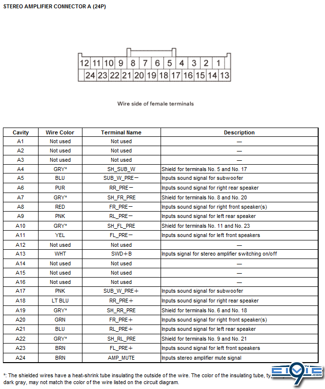

Does the OEM amp work all three rear speakers? i have my incoming speaker wires spliced into right and left rear, but if they are already amplified could that cause my aftermarket amp to throw a protect light?
^ amplifier connector.... showing signal wires for subwoofer, fronts, & rear speakers
