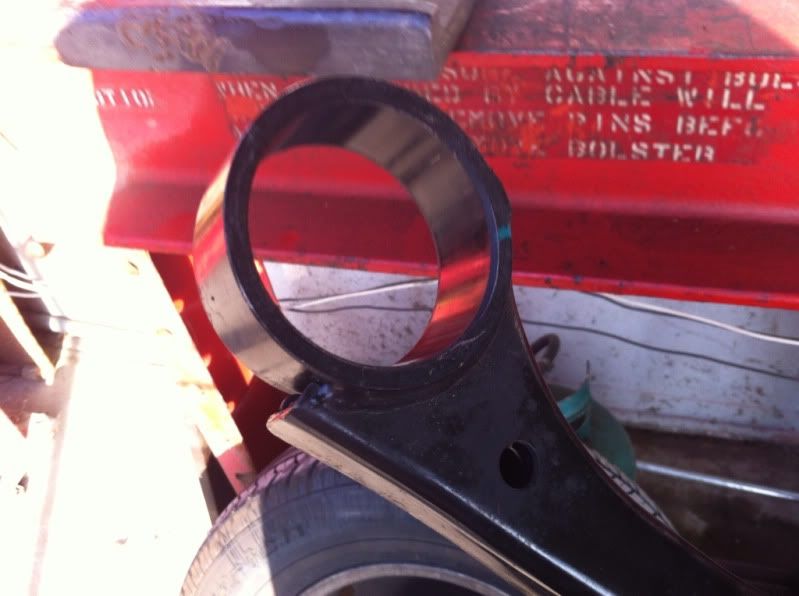

If you're willing to guinea pig it I can suggest a traction ball alternative that won't break the bank. You will definitely want to go the traction ball route as the wheel hop is controlled by the compliance bushing in the front lower control arm. The most forward location has a large rubber bushing that lets the arm move up and down. It's number 16 on this diagram. That's where the traction ball will go.
BUSH, FR. COMPLIANCE - 2013 HONDA CIVIC SEDAN (51391TR0305)
ill2.php

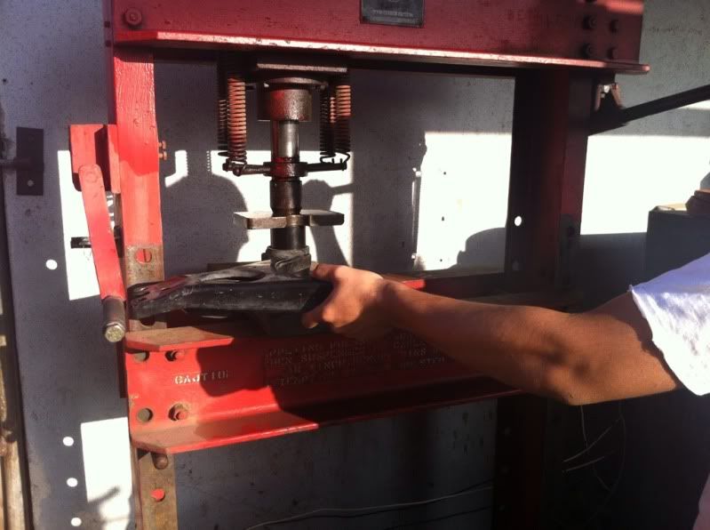

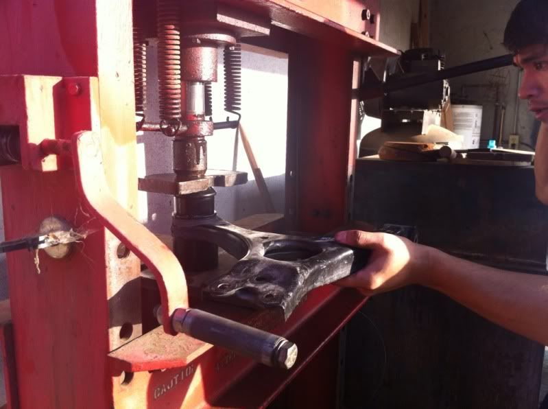

I have a sort of upgraded "compliance bushing" / traction ball on my car currently. It really tightened things up a lot. However, I have an 8th gen so I do not know exactly what part to recommend you. That said, if you ordered a new one of these and measured it carefully you could probably match up to what I'm using.
The 9th gen compliance bushing part number:
(51391SNA305)
The 8th gen Compliance Bushing is the same on the Si and non-si. Part number is :
(51391SNA305)

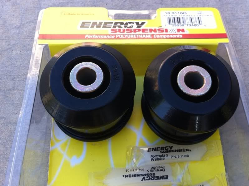

The numbers are pretty similar. It might fit. I am running a poly bushing from Energy suspension. On the 8th gen the LCA was the same as the Acura RSX so I just bought those and pushed em in. You would have to fool around with figuring out which size bushing to try. It might be the same but it might be completely different. Just a suggestion.... not responsible for you buying the wrong one and wrecking your car, but perhaps an idea worth looking into since traction balls are like $300 and these are $50.
These are from Energy Suspension. their item number is 16.3116

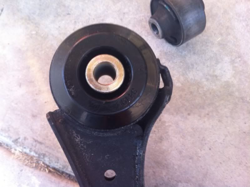

And size comparison of the new bushing vs the old compliance bushing....
There is also a red Prothane version out with more cutouts that would probably offer a softer ride. These things make the ride very very harsh but super tight as well.
http://www.energysuspensionparts.com/proddetail.asp?prod=8223
I don't like the currently available poly version because you are rotating the arm in the direction opposite what those bushings are best made for.... if they rotate radially with the bushing, then fine... but they don't. The traction balls are definitely better suited for this location. I suppose they will work, but I hate doing things that are half-assed like that..... and a poly bushing isn't meant to flex like that. It's meant to resist flexing in that direction usually.
