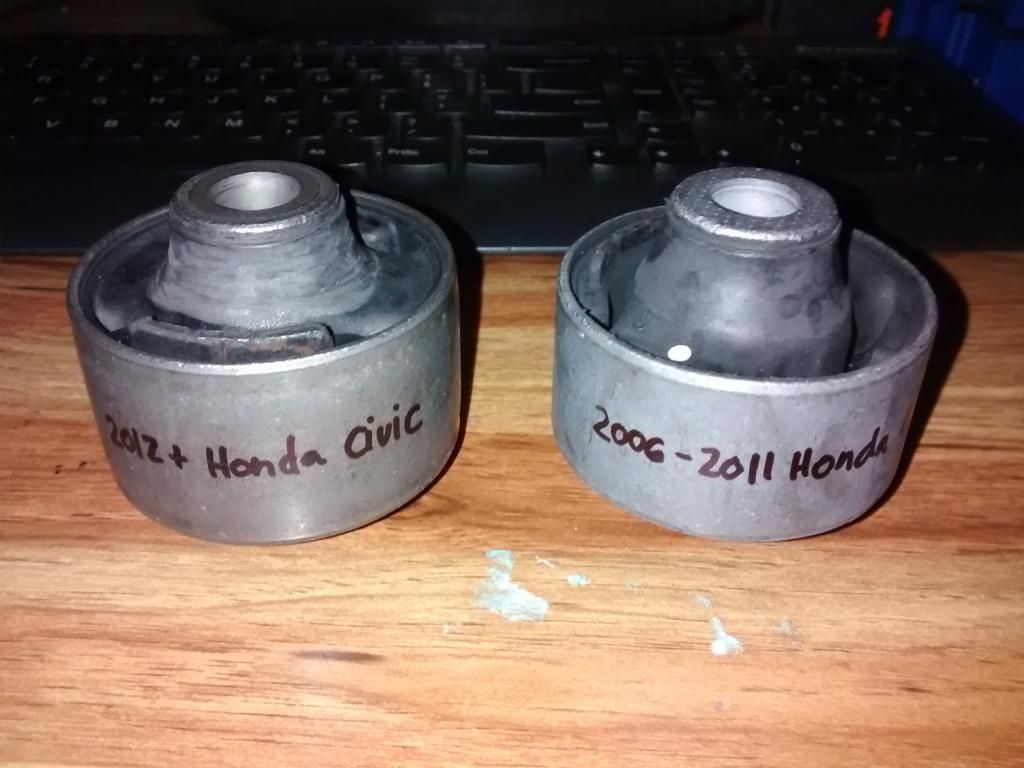

And the answer is a "NO".
So I have the OEM Compliance bushings for the 2012+ Civic (Left) and 2006-2011 Civic (Right). And here are the dimensions:
2012+ Civic:
-Max O.D.: 2.64"
-Max Height: 2.4775"
-Metal Casing height: 1.455"
-Sleeve I.D.: 0.56"
-Sleeve O.D.: 1.07"
2006-2011 Civic:
-Max O.D.: 2.57"
-Metal Casing height: 1.265"
-Sleeve I.D.: 0.56"
-Sleeve O.D.: 1.07"
The only major difference between the two compliance bushings is the maximum diameter. Even a 0.07" difference is pretty significant for fit and function. Therefore, a 9thgen cannot use 8thgen aftermarket compliance bushings (Energy, Traction Balls, etc).
