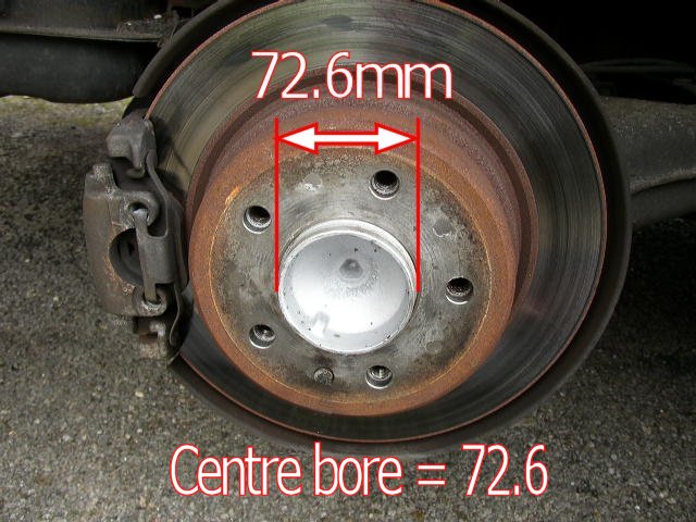

The Subaru BBS wheels are not a direct fit on the Civics. The center bore for the Civic is 64.1mm, 56.1 for the Subaru. You will have to make the center bore on the BBS wheels to match the 64.1mm in order to make it fit.
Example of a center bore:
Another option is to get wheel spacer adapters that changes the center bore from 64.1mm to 56.1mm.
