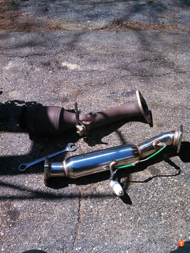

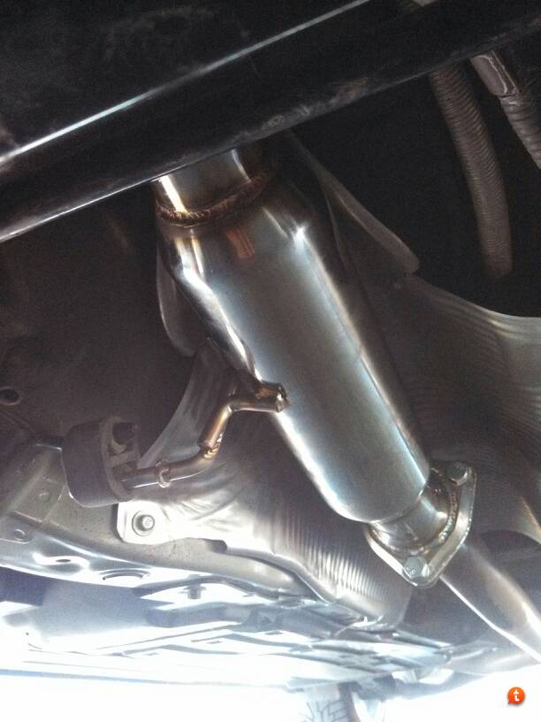

Tsudo test pipe installed yesterday in my 2012 si :0)
