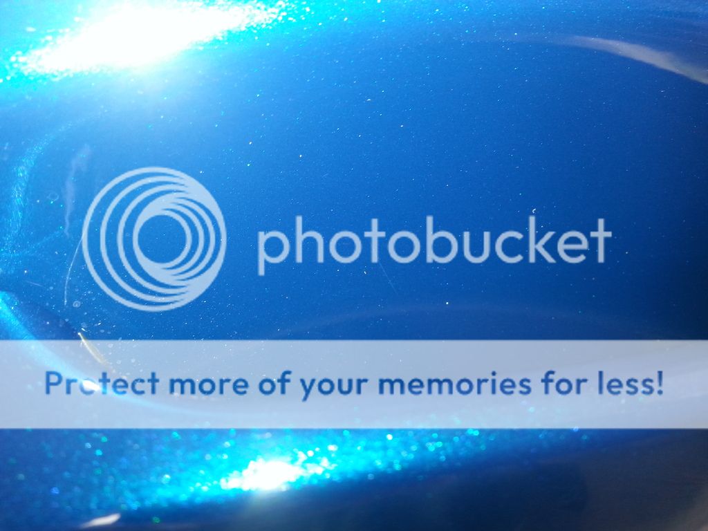

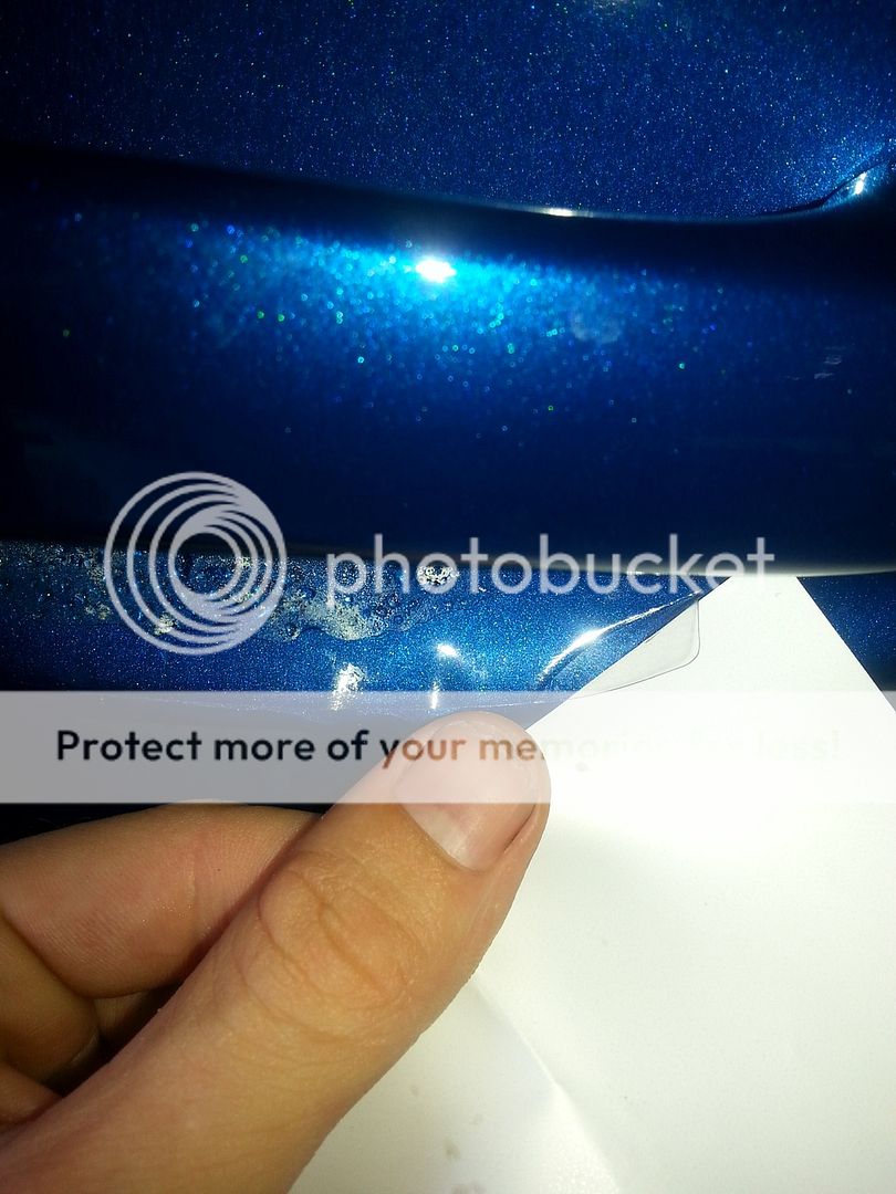

Below is a pic of one minor scratch that i have in my drivers door cup, over time these accumulate.

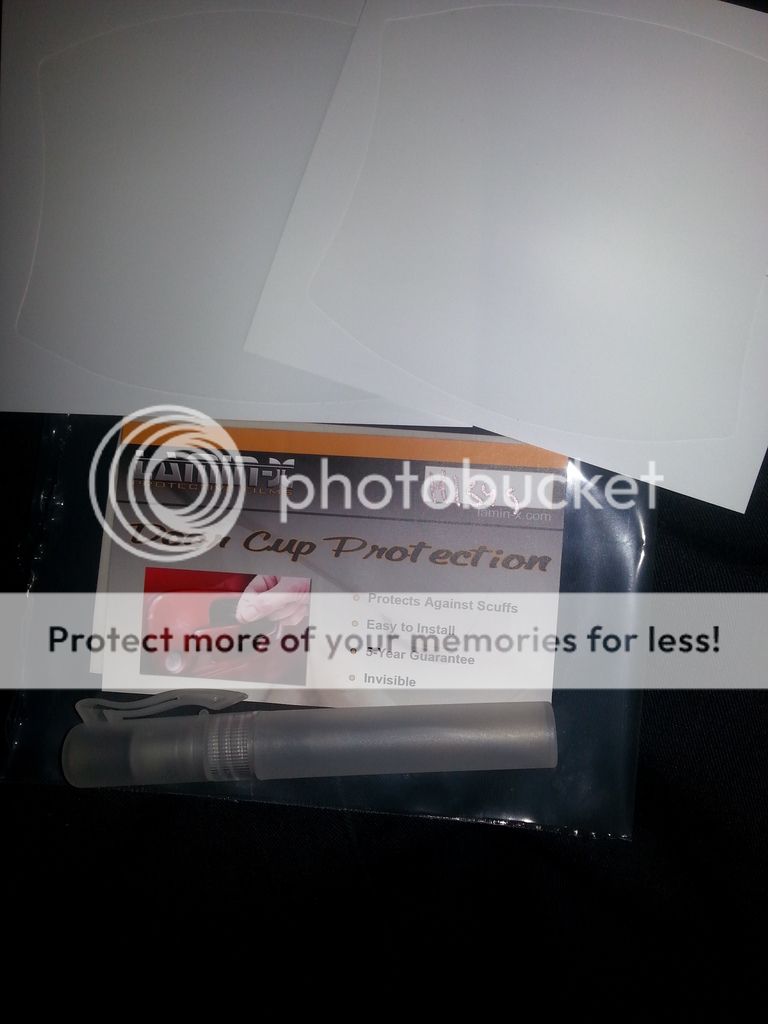

The Lamin-X Protective Film, Door Cup Protectors kit contains: (for a coupe)
- 2 Lamin-x Door Cup Films
- Mini Spray Bottle
- Bag with instructions on back
(sedan package would presumably come with 4 films)

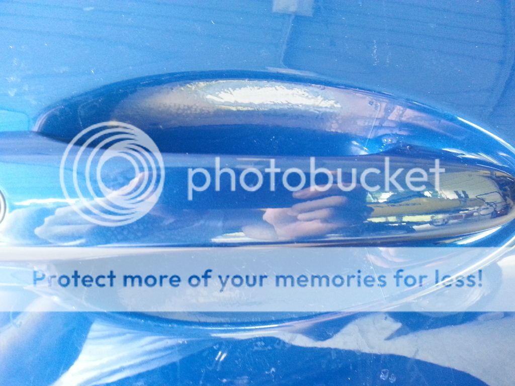

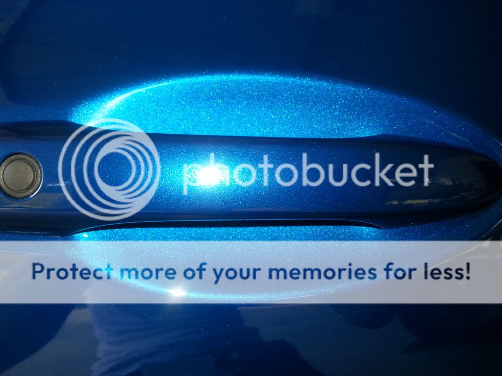

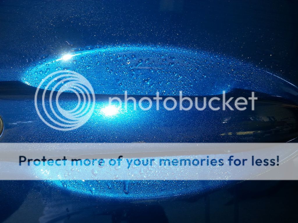

Below is my passenger door cup washed and dried.

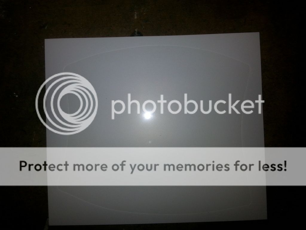

Now in the picture above you can tell where the handle curves off the door (towards the camera) in the front and rear. It may be hard to tell but the front portion has a slightly bigger gap (top to bottom) than the rear portion. (Can add a pic with arrows to show what i mean if you don't follow) The Lamin-X cut-outs have a similar off set (seen below). The film below would match the passenger door seen above.

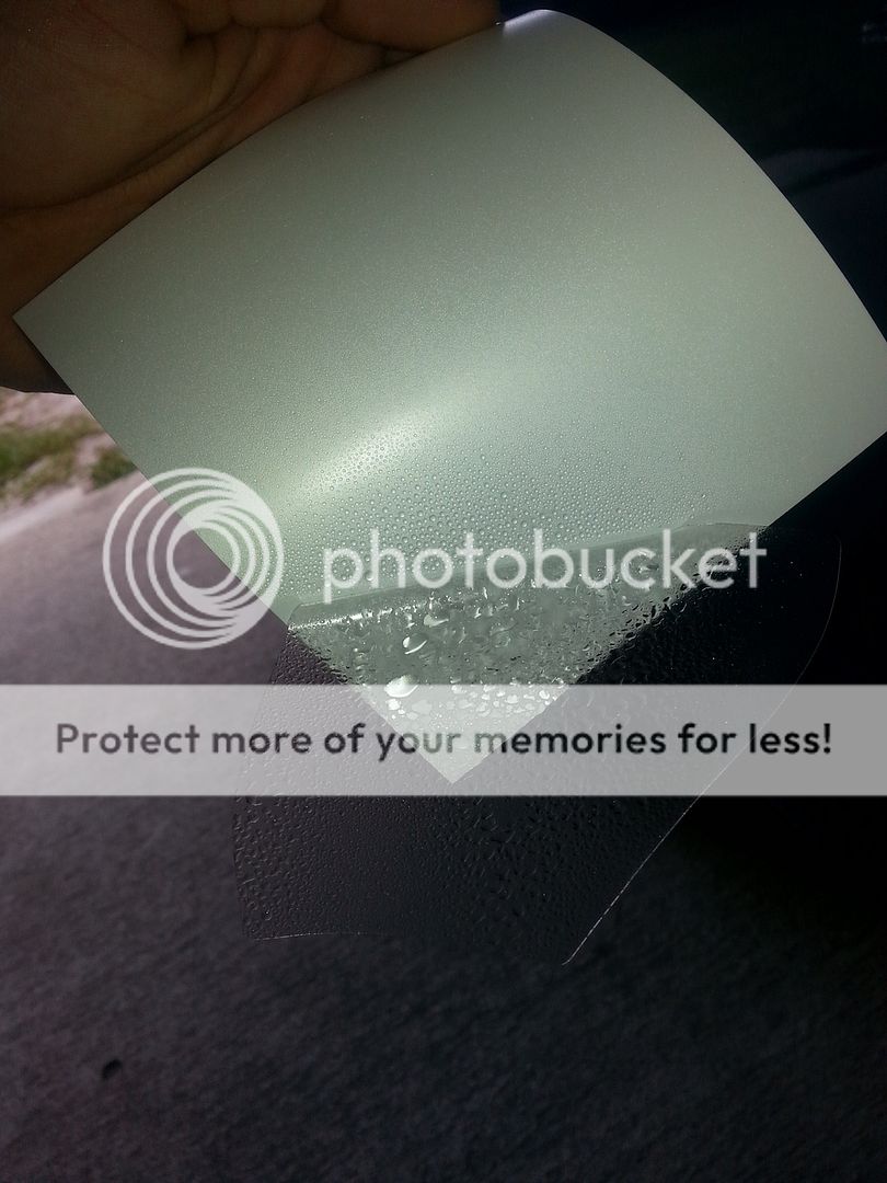

Grabbing the matched film to the passenger side i peeled off about 75% of the film and sprayed the backing with the spray bottle.
I grabbed the wet film and fully peeled it off the backing and finished soaking it in water with the spray bottle. I then carefully slid it down in the door cup. If it happens to stick at any point don't be afraid to peel it off and move it. Until the water evaporates the film wont fully stick. I will WARN you to be EASY when PULLING the film back to adjust/try to remove any debris that may ave floated behind the film during application. You can stretch the film out of shape. Not a huge deal but can be annoying if your a perfectionist like myself.

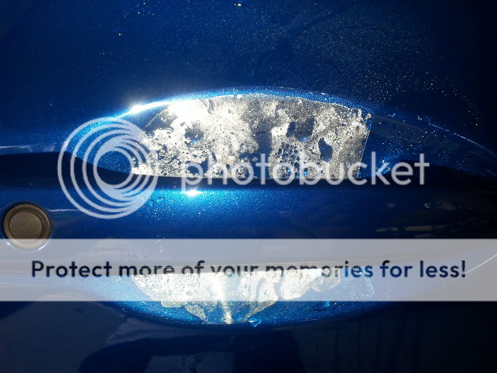

Below is a pic of the film softly applied as i try to find the proper fitment.
The instructions suggest to remove the bubbles and adhere the film by pressing the film from the center out with your finger. I agree completely as this is the best logic to remove bubbles on any decal you may be applying. Problem is knowing where your "center" really is.
I started from the top on one side and the bottom on the other and tried to align the curve of the film with the curve on the door. (You can kinda see it above) It took time and playing with the film to maneuver it in the spot i felt comfortable with.

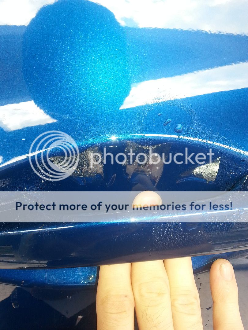

You will have to figure out the alignment and press half the film down (starting from the edge you aligned) to see if the opposite will line up. Peel up, spray, shift film, press to check alignment and repeat. No way will you get a one shot stick. As long as you keep the film backing wet you should be golden to adjust it for hours. (Below is a pic of me pressing the film up from where i attempted to align the film on the bottom initially.)
