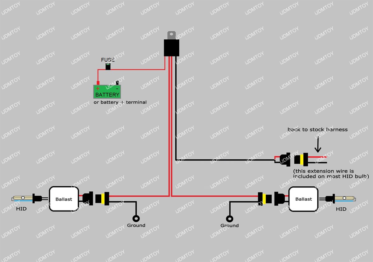

Here is a great simple diagram of where everything goes:
1) Red Power wire with Fuse to the positive on the Battery, the fuse is included with the harness.
2) Long red wires to each ballast
3) Each ballast plugs into each bulb
4) Black ground on the end next to each ballast with the "ring" connector
5) The black box at the top is the relay, the cord on this plugs into the stock system so your headlight controls work just like always.

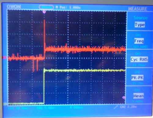

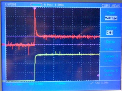

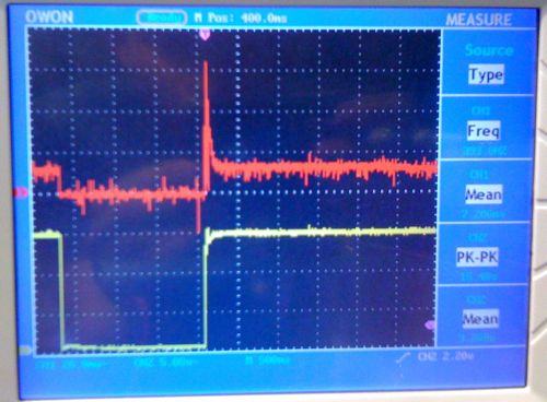

The author tested a few ballasts under warm and cold start conditions, just to show the amperage spike that happens when you first turn them on. Though he notes that the spike is too short in duration to blow a standard fuse, you are still pushing far more power through the wires than intended and it can cause a repeated fatigue situation where eventually you will develop issues with the stock wiring.
TrialColdWarm
Halogen Cold ~4.52a average (15a peek < 20ms) Warm ~4.52a average (14.25a peek < 13ms)
Osram H11 55w
Control Cold ~6.63a average (20a peek < 15ms) Warm ~3.38a average (14.73a peek, < 30ms)
Xentec 35w
HID50 Cold ~5.1a average (10.91a peek < 25 ms) Warm ~4.09a average (14.73a peek < 20ms)
50W Slim
DDM Cold ~4.36a average (13.64a peek, < 20ms) Warm ~3.95a average (14.93a peek < 20ms)
55W slim
Expand the quote.. .DDM info is the last one.
