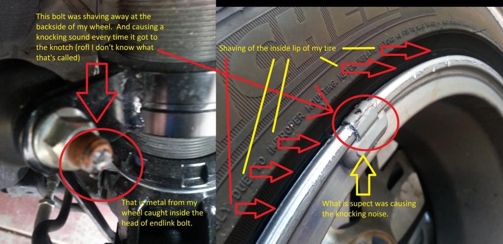

I was feeling really beat and exhausted by the time i finished up my coilover installation and didn't tighten everything all the way. At first glance everything looked as it was supposed to, but i soon after realized that my sway bar endlink looked a little out of place. Here is what was wrong with mine and how it can be corrected.

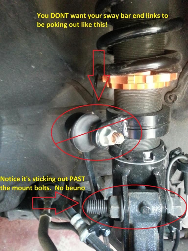

This is a picture of what my set up looked like when i took the wheel off. This is NOT what you want.
It will cause problems, and I was very lucky that the endlink ball joint didn't pop out of it's socket. Mine actually started scraping away at the inside lip of my wheel. I fixed it before any real damage was done.

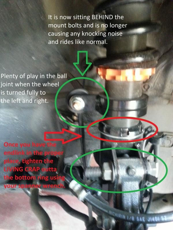

This is what you wanna see when you're all done adjusting everything and DON'T FORGET TO LOCK IT DOWN TIGHT!!!
OH AND ANOTHER THING I FORGOT TO MENTION/TAKE PICTURES OF: THERE IS A ALAN HEAD BOLT ON THE ENDLINK HOLDER THAT NEEDS TO BE TIGHTENED TO PREVENT IT FROM SPINNING. THE BOTTOM RING ON THE STRUT WILL PREVENT THE ENTIRE STRUT FROM SPINNING!!! If anyone thinks that's unclear or could explain it in a simpler way, please do and again this is only ONE of many many things that could be causing knocking.
