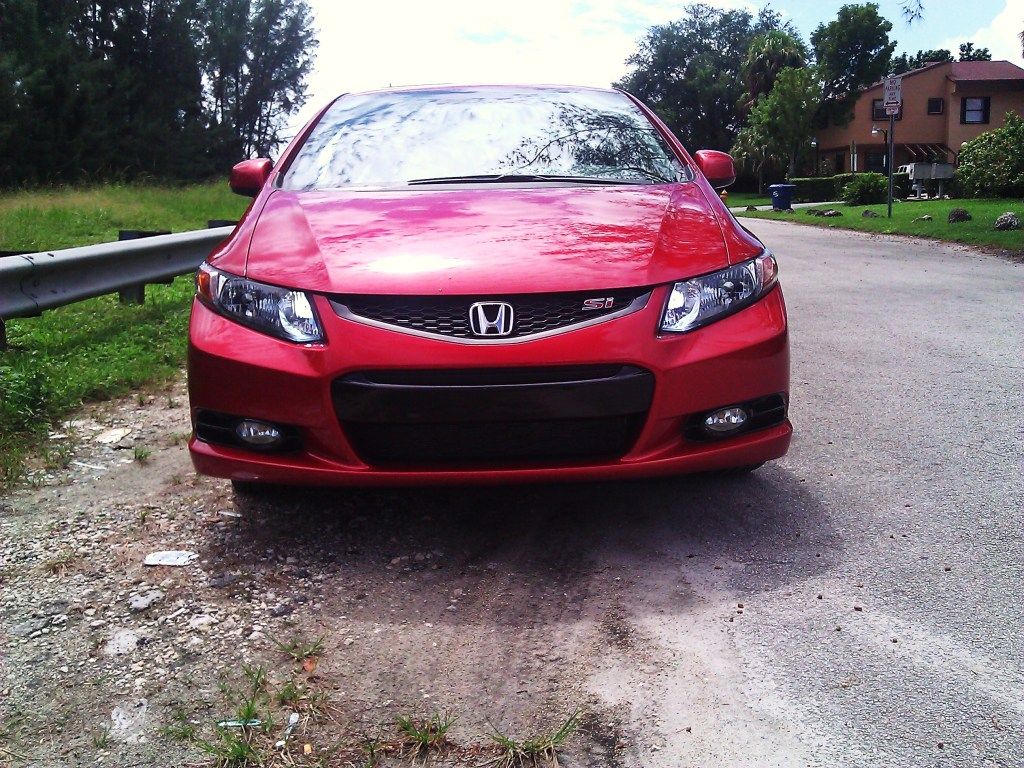

Hey guys was installing a new decoder for my LED DRL's and i seem to have popped the fuse for DRL's.
I check the fuse (21) and it seemed intact, popped it back in and drls still dont work, changed it out for another 7.5 and still didnt work.
By the way i disconnected the decoder after it seemed to pop the fuse.
What else do i need to check?

Worked fine for a second when i installed them, then they turned off. I installed just the intensifier directly to the light bulb, without connecting it to the other piece. Wanted to see if i could get by with just running 1 cable per light to get no warning and the brighter lights, but no cigar.
Now i am trying to turn them on with just the stock plug connecting to the LED and they are not working, i think its soemthing with the fuses, ive never really worked with fuses before and only checked and reinstalled #21 which didnt do anything.

Both #38 and #39 were blown. Replaced them and all works well now.
All pieces work together, however on the intensifier there is a piece that has double polarity and may have to be turned the other way for the lights to turn on
They look good and how i want them to now. Before you would only be able to tell they were on in the late afternoon since they werent that bright. Now its noon and you can clearly see them
We're those the high beam fuses? Glad it's working for you now :thumb:
