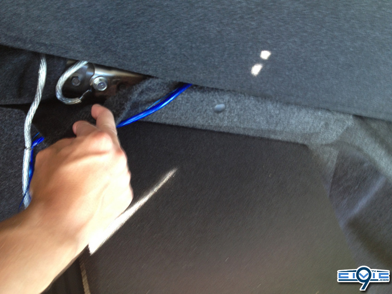

The bolt on the back of the seats has been measured to be a perfect ground. Took this from the DIY section. Lift up the carpet (held down by velcro), take the bolt off, and scrape off the paint down to the bare metal.
Here's a link to the entire install.
http://9thcivic.com/forum/threads/2...ll-high-level-inputs-from-rear-speakers.8820/

The location I quoted is actually behind the rear seats. That pic shows the rear seat bolt. That wouldn't be far enough back for you?
No, the wider part of the trunk to there I for need another 14+ inches on the ground wire. You know where I mean where it's wider right? I know where you are saying is good, but I wanted the basslink off the spare tire cover, so I already used self tappers to mount it in w L brackets
I ended using the bolt under the seat. You have to remove the small bit of moulding, but then it works great. I actually drilled a perfect size hole in the moulding to prevent the wire from getting crushed.
