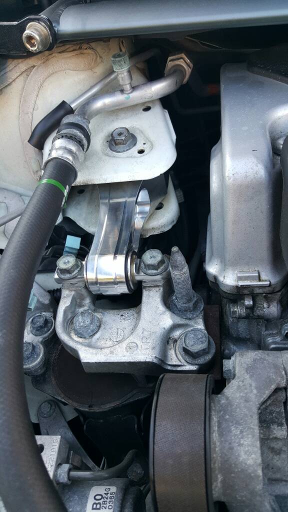

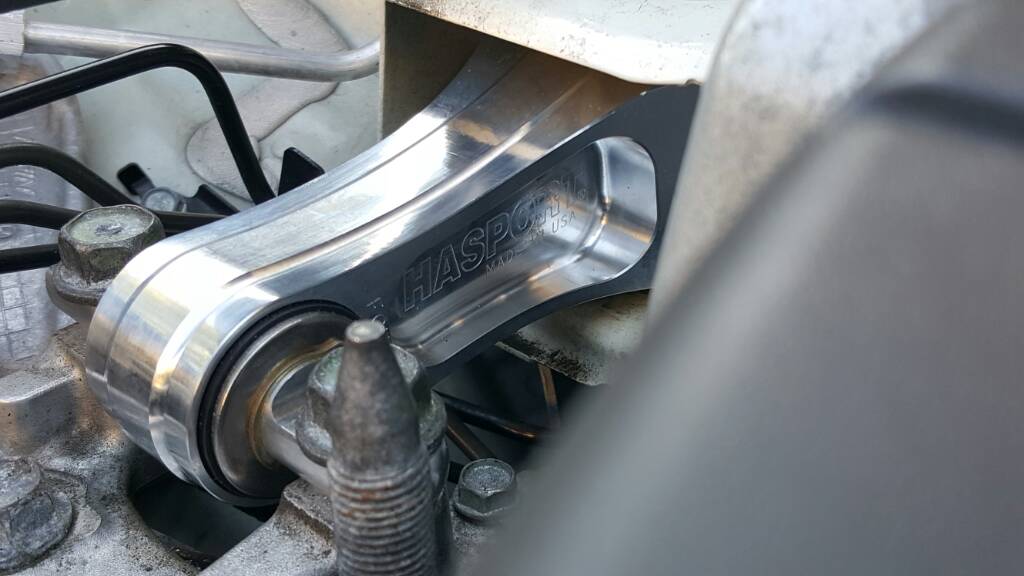

Got it today and installed it.
Car feels great. I would say vibrations have actually decreased since installing it. With the 62a rear motor mount I had some sight vibrations above idle, and when the a/c was on. There wasn't vibrations through the entire powerband, and none of it was even remotely bad enough to complain about it. With the 62a torque mount installed, it almost seems like vibrations have actually decreased. The motor feels more solidly planted, and I think the rear mount caused less pivoting of the motor under load, but the weaker side mounts caused vibration. This actually tightens that up, there is still vibration but it feels cleaner. It's hard to explain. Almost like it vibrates at s different frequency now. It isn't more prominent in any part of the powerband, and in some cases feels less than before. So far I am very happy with it.
Pics:
