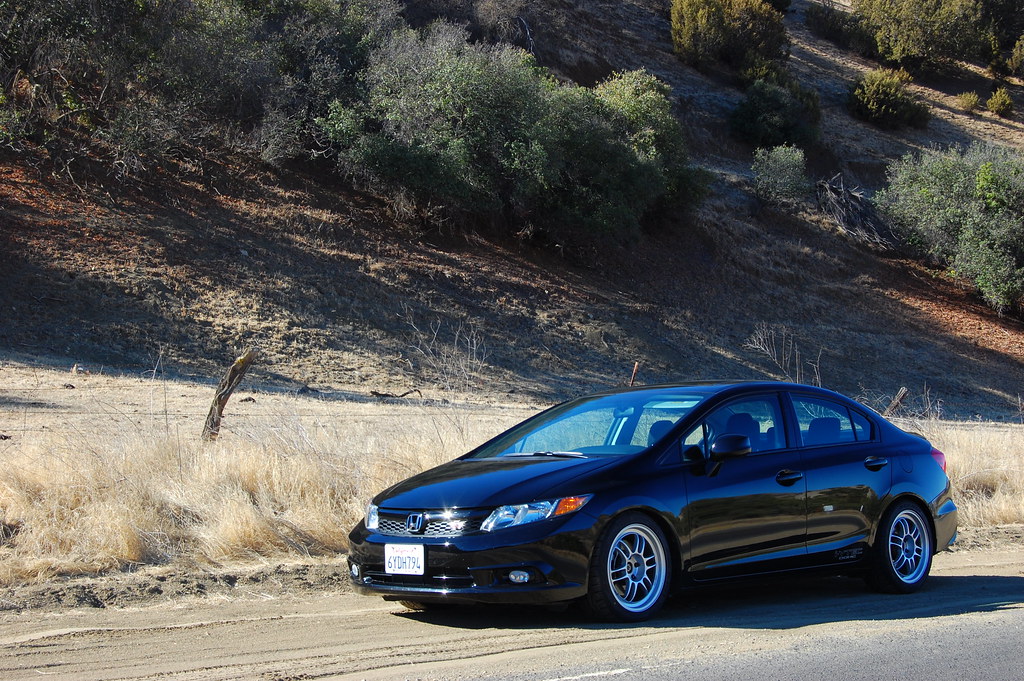

For me this is the perfect drop look below. It's lower than stock, but you won't scrape or rub. Anything lower than that is pointless IMO and pain in the a$$ to drive anywhere. Unless you are on air ride.
