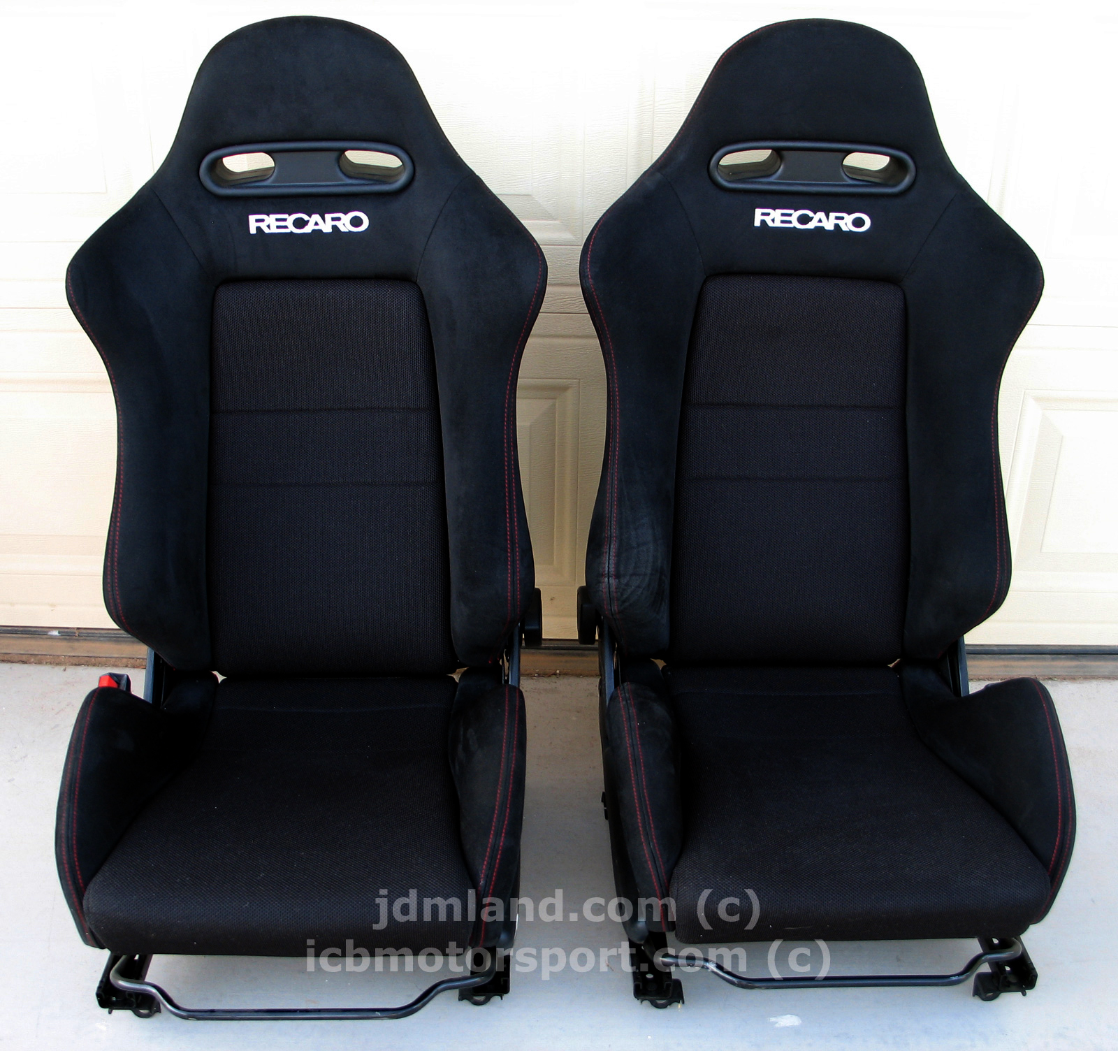

anyone have any suggestions on seats or some good fitted seat covers? i was looking at some black leather rsx bucket seats and found a pretty good deal, included rails. can anyone confirm the fitment? will there be any major wiring modifications i would need to do because to my understanding, our oem seats have sensors on them.
Research I've done looks like all dc5 seats have side airbags. Not sure if you can determine the wiring plug style under the seat for the airbag? In theory, if the plug were the same they'd operate just like your oem side airbags.

Once a bracket solution gets figured out. Both DC5 RSX Recaro seats
^i've got the seats ready to go in -- just need brackets -- tempted to try 8thgen rails.... anyone tried that yet?
eesh... Aftermarket seats generally don't hold up well in crashes. On the previous gen civic taking out the OEM seats not only removed the side airbag that was built into the seat but if the system detected one airbag gone it disabled all of them leaving you with little protection. It is also a huuge liability if you are in a crash and your insurance finds out you had a disabled or removed safety system.
The seats don't have to go through the same testing that OEM seats do for impact and the mechanism that allows the recline is usually pretty weak. Also the "racing seats" generally need the harness bar or roll cage to prevent this from happening. First of all, the only safe place to mount a harness is to a bolted in roll bar or roll cage. Anywhere else, and it is likely to fail. 4 and 5 point harnesses decelerate your body instantly in a crash. This means that your body won’t move forward, but your head will. This will result in a debilitating or fatal neck injury, even in a low speed accident. . This is rectified with the use of a HANS. Don’t think you need a HANS? Ask Dale Earnhart about the HANS. Also, if you have a front airbag, you won’t reach it with a 4 or 5 point harness, rendering it useless.

Also I could be wrong but the major sticking point is not that the new seat won't have a side airbag. It's that the system for airbag monitoring from Honda does not allow you to just remove one. The circuit disables all the other airbags as well.
