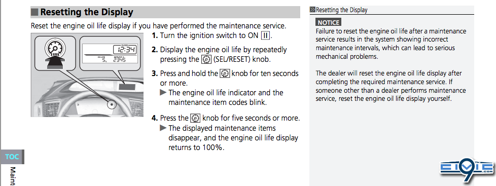

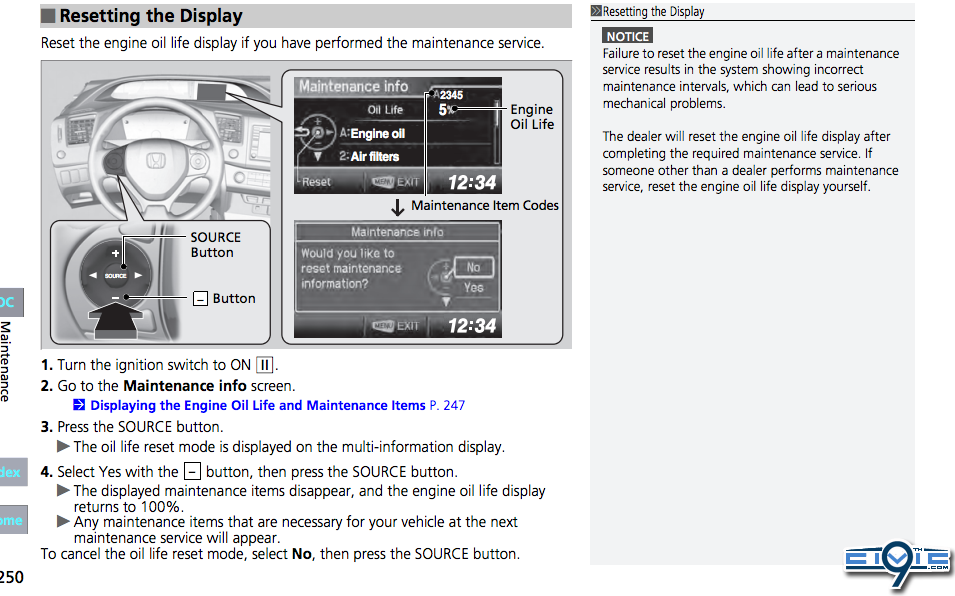

maintenance info how to clear
from the manual -
i am talking about when you go into the mat info in the imid screen it says oilo life 100% but there is other stuff under it
4) says the maintenance items disappear.
so from the last pic, you can't get to the "would you like to reset maintenance information" screen? Engine oil, air filters... etc
when i rest it it just resets the oil life then when i go back in the mat info it says oil life 100 % then under it it says oil and filter and rotate tires how do i clear oil and filter and rotate tires
