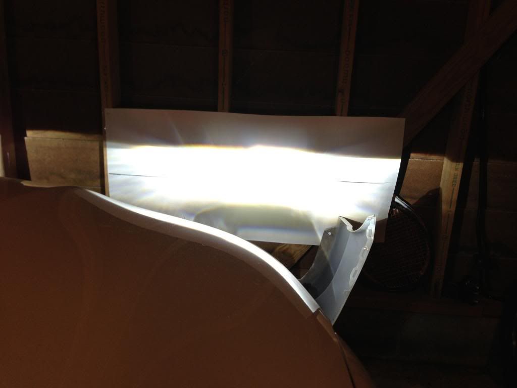

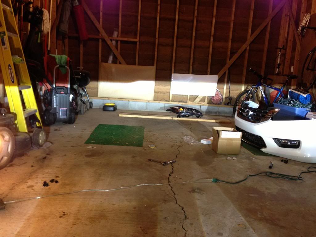

Got most of the way done on the TSX projector retro fro my Accord but trying to see what you all think about the cut-off "levelness" before I seal the headlights back up. Trying to decide if I should drive to a parking garage with no bumper and headlight lenses. Not sure I want to do that.

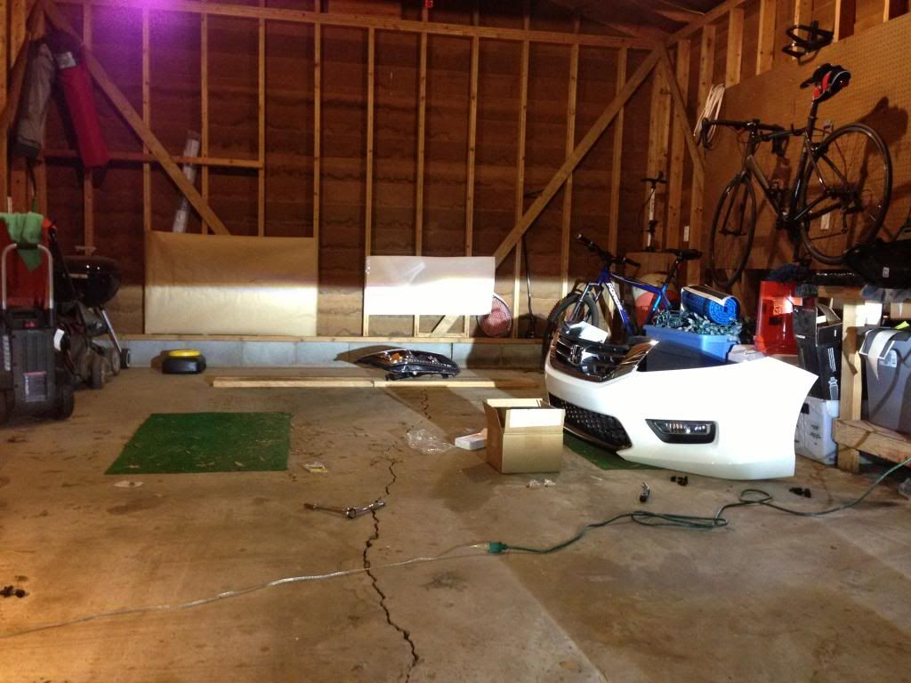

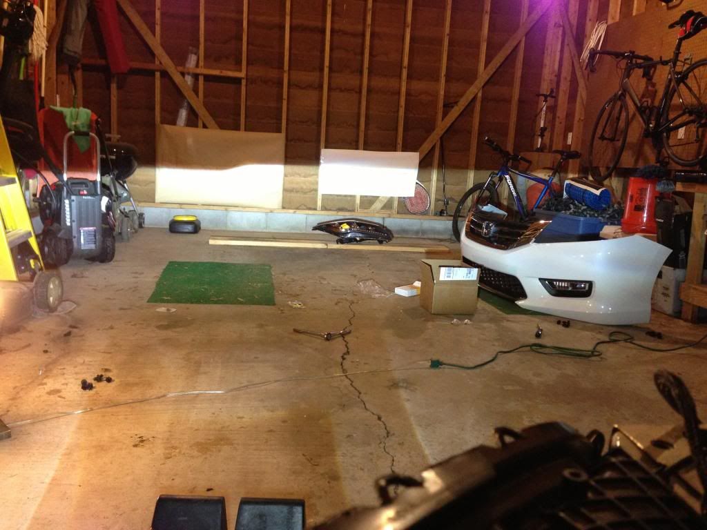

Disclaimer: Pics are crooked and taken from an iPhone. first 3 pics were taken 5-10 mins after the car came off some ramps. Last two pics were taken 25-30 mins later.
Here are both of them on....on the far right by the bike you can see two cut-offs if you zoom.
Right side....if zoomed you cants see the line on the white paper but you can see the on the brown paper.

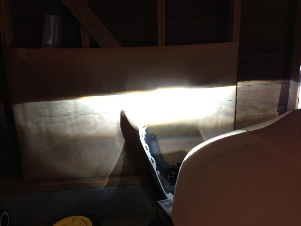

Left side....is zoomed you can see the black line on the brown paper.
They kinda look slightly off to me but when I took pics up close they are equally spaced away from the lines for both sides. on both, the lower step are 4 inches away and on the upper step they both are 3.5 inches away.
they look pretty dead on to me, remember the TSX projector likes to flare up off the top of the cutoff which can be deceiving
I did notice that on the left side but not as much on the right side. I think I just might roll with it.....kinda need the car tomorrow.

When I set up headlight alignment on my cars, I'll get them as close to even as possible, then work on them to fine tune by blocking the light of one and then the other.....It's a lot easier to see what's going on when you can block the interference of having both uncovered..... once you get one where you want it mark the wall and work on the other one.
Ethlar hit the nail on the head with them flaring up. I think they look good from those pics. :thumb:
That's how I aligned mine also....one side at a time. Did that with the stock lights to get the lines on the paper then did the same with the modified lights.

with tsxs, I line up the left sides of the cutoff.. like ethlar said, tsxs have that flare which throws everything off..
