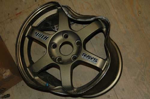

Thanks guys lol and @Nix I would like to avoid xxr wheels just because I know they're not the best and I've read forums where peoples wheels just literally fall apart. I'm looking into ASA wheels at the moment
I'm the same way..I drive low and slow but I've bent a VS-XX lip before driving over an avoidable manhole, but never had issues with my battles or varrstoens.
