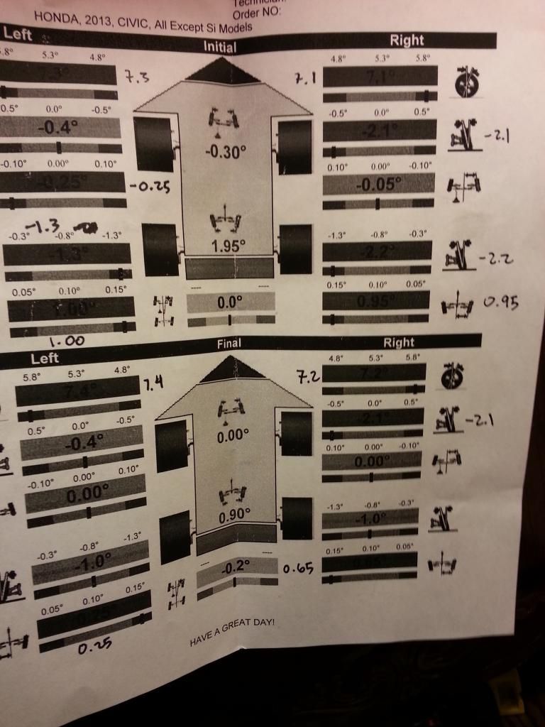

I know my end result after my alignment is still funky... and might be hated on for whatever reason.
As for the front camber that's way off. I'm not running front camber bolts, but i plan to soon. The guy who did my alignment said the 2 sides aren't identical because my preload was off or i didn't measure correctly on height :P
The main problem:
The guy who did the alignment said that he couldn't get any closer to factory toe specs in the rear and even played with the rear camber to get at least as close to possible and at least try to achieve best of both worlds. (toe and keeping some camber so i don't rub my tire against the inner fender)
(My rear suspension is as low as it gets and even took out the 2 rings along with maxing out the strut. I am also running rear camber arms.)
Is it because I'm too low or is these a toe kit i can get? Nothing like eccentric toe bolts for the rear?
