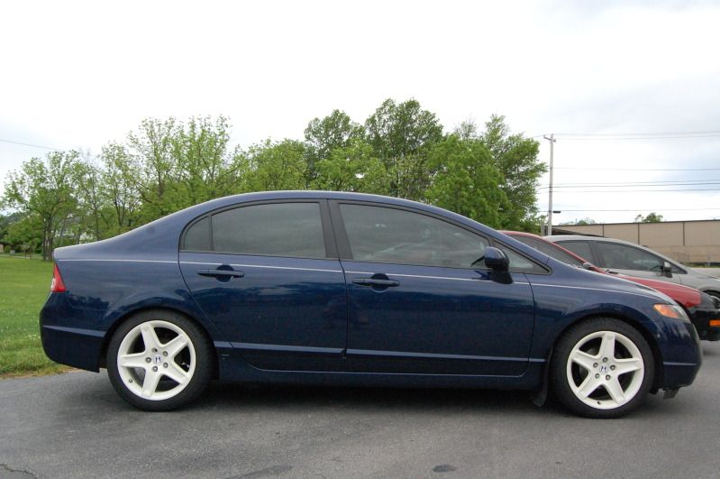

I running a 17x8 +45 offset wheel running a 225/45/17 Conti DW's tire?... As for the tpms I have no clue...

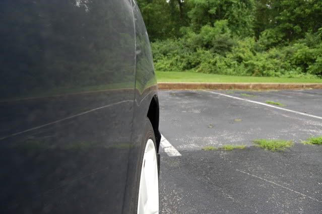

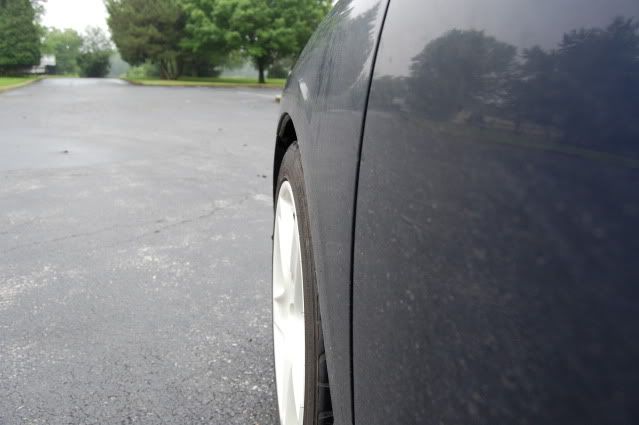

My setup on my 8th makes my wheels sit flush and even with the car lowered a inch no rubbing
Front
Rear
do you have springs?
HFP springs and Tockino Blue Struts..
