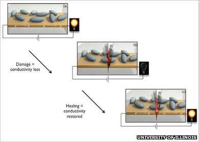

The process works by exploiting the stress that causes the initial damage in the chips to break open tiny reservoirs of a healing material that fills in the resulting gaps, restoring electrical flow.
Cracked circuits
To test their theory the team patterned lines of gold onto glass to form a circuit.

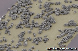

They then either placed microcapsules 0.01mm wide directly onto the lines or added a thin laminate into which they embedded larger 0.2mm microcapsules.
In both cases the microcapsules contained eutectic gallium-indium - a metallic material chosen for its high conductivity and low melting point.
This device was then sandwiched between another layer of glass and acrylic and connected to electricity.
The researchers then bent the circuit until it cracked causing the monitored voltage to fall to zero.
They said the ruptured microcapsules then healed most of the test circuits within one millisecond and restored nearly all of the measured voltage.
The smaller capsules healed the device every time but were a little less conductive than the larger ones which had a slightly lower success rate. The team suggested that a mix of differently sized capsules would therefore give the best result.
