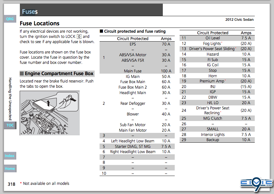

look at your fuse box in the engine bay -
left side low beam light - #4
right side low beam light - #6
chart below
the interior fuse box has stuff for the high beams -
#38 & 39
check those and report back
