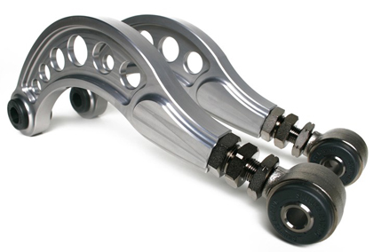

I am not a fan of the design of the megan camber arms. They look to be stamped steel welded together where most other camber arms are a solid billet piece. I know they usually are a more budget friendly option but I see them listed for $250-ish. I know the Godspeed arms can be had for significantly less money and have, I think, a better billet design. Also being that close in price you could pick up the Skunk2 arms which I think are a very nicely designed arm. Some of the bushing issues have already been addressed and can be remedied quickly. (I do have the skunk arms myself so im kind of partial)
Ok so from Procivic the megan arms are $225, the skunk2 are $300, and the DME are $250. If you are looking to save a little I would probably point you at the DME arms.
I just see welds failing, rusting, or cracking at the ends where the forces are or all along the seam. That "pinch" design on the end with all the adjustments doesn't look as solid to me as the other arms. Also I see water getting into those holes and eating the arm from the inside out. For $25 i'd maybe consider the DME or another similar arm. (godspeed etc...)
Megans: 2 stamped steel sides welded together. Questionable steel quality and questionable welds I think.
The DME is another Skunk2 clone.
Both are solid billet aluminum arms with steel inserts for adjustments. Very similar.
And the Skunk2 arm:
I typed out Megan and meant Skunk 2 :mad: but great point on the solid billet point as opposed to the welded ones. I want to get the gold ones! and so the sway bar will be good, but just be sure to use the reinforcement brackets?

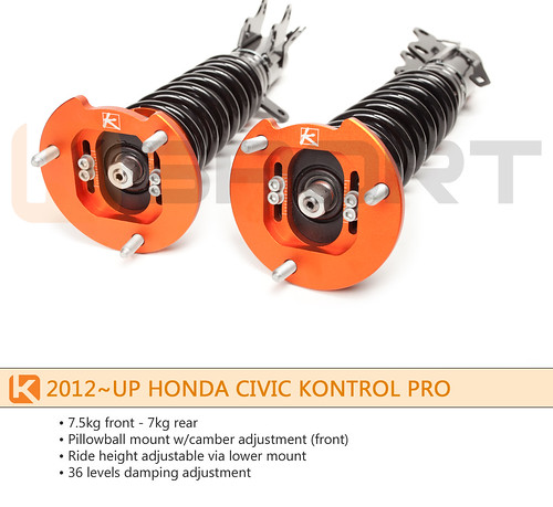

And I am looking at the Kontrol Pro coils, theyre about 980$ or so. (I had them on my boosted DC teg and loved them)

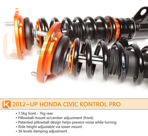

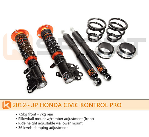

Ah, the control pros have the camber plate at the top. You shouldn't need the ingalls camber bolts with those coils. Save you some $$ there.
These ones correct? Stole the pics from Ksports website.
Yep those are the ones! I didnt know they came with the camber plates though. That's awesome. Now I just gotta wait a week or so and I will have it all ordered. Also already talked with @VitViper about the full race downpipe, PRL intake, and his flashpro deal. Should be pretty sick when its all done! :cucumber: cant really think of much else to get other than maybe the updated headligth housings, and red illumanting lights for the interior.
