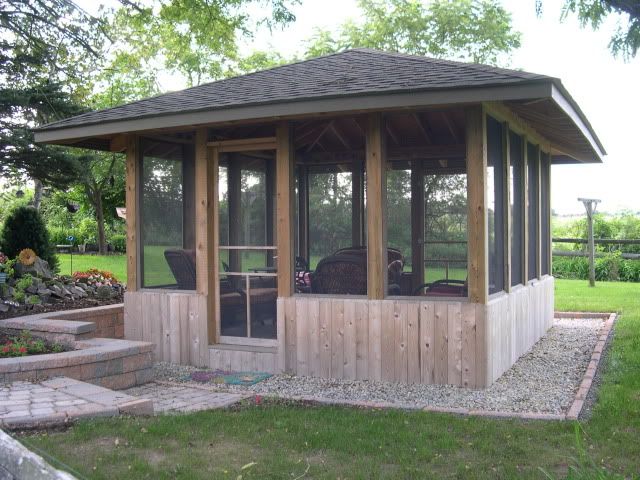

I built Marla a screenhouse with my own two hands a couple of years ago. Every bit of the labor was my own. I'm guessing between total construction and landscaping around the outside, it took me a total of just over 1000 hours. My cost for materials came to around $8000. The floor is 13' x 14' with a large overhanging hip roof.
I can see his home is bigger than my screenhouse, but looking at the materials he used, I'm a bit surprised he even spent as much as $5000.

that looks awesome Ken! Is the floor inside made of pavers, or concrete, or..? For the other house, you have to figure plumbing, electrical, straw bales, wood burner, .. he has a kitchen..
I know he recycled a lot of goods, but he just said it was under 5k.
That's true. I guess the electrical/plumbing systems added some expense, although I didn't figure the kitchen appliances were included.
The floor in the screenhouse is composite lumber, which was about $1000. I also installed electricity in there too (outlets, switches, lights, ceiling fan). The "skirting" around the outside is western red cedar 1 x 6 boards.
If I exclude the cost of the wall blocks and other landscaping materials, then that removes about $2000.

wasn't even thinking about composite. Good choice for longevity and maintenance. If you get close to the building, can you still smell the cedar?

Sweet screen house Ken.
