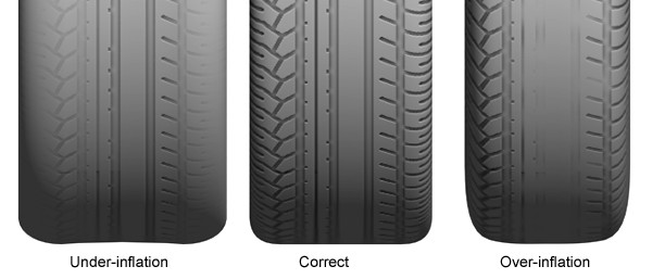

Running the tire pressure too high will cause the center of the tread to wear prematurely. Same as running too low, the edges of the tread will wear before they should.

higher you go, the greater chance for uneven tire wear as ^ said. It will wear in the center of the tire first.
The higher you go, the more harsh the ride will be as well. I'd stay right around 32-36psi and watch for any uneven tire wear and adjust accordingly.
