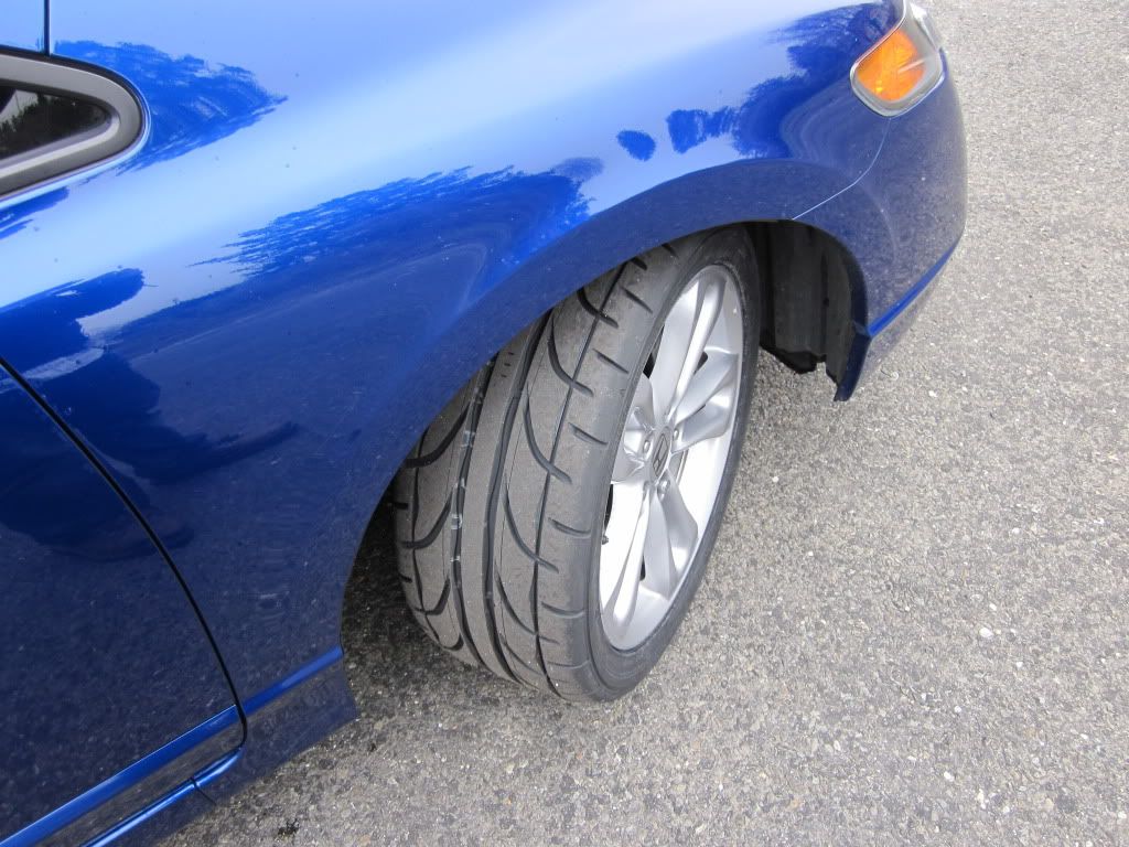

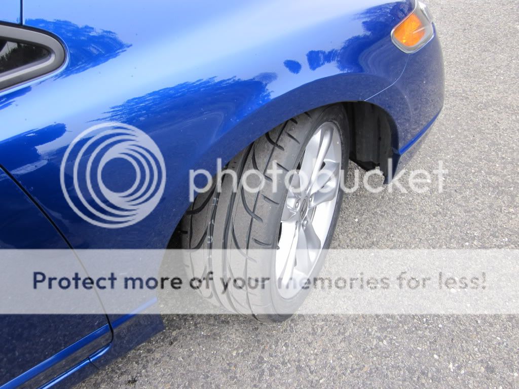

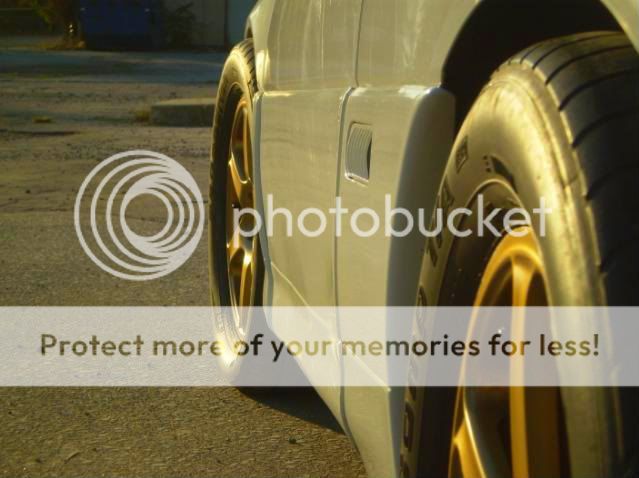

Testify's auto-x setup. 235/40/17 Star Specs on 17x7 stockies. Lol. The width looks just the same as the 225s on my car.
how much of a drop did those springs give you again?? :confuzzled:

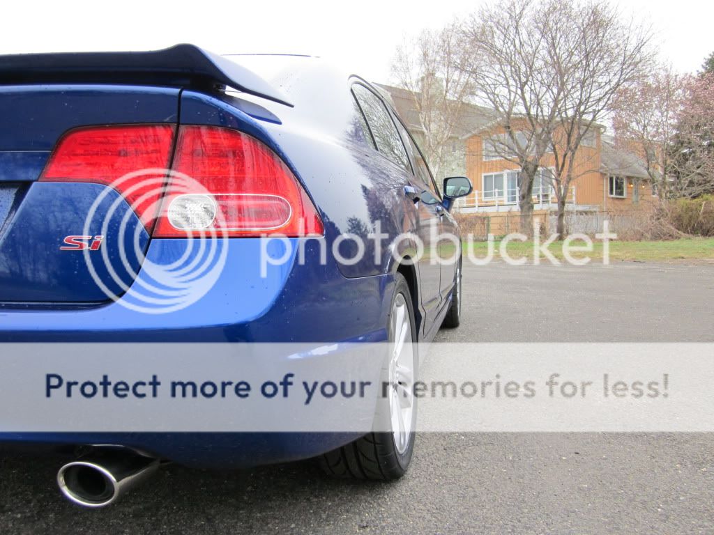

Tanabe rated it as .6" front/.9" back on an EX. But I think since the Si has a bigger engine, the drop is lower. It's about 1 finger gap. 1st pic was on stock height, btw.
Tanabe rated it as .6" on an EX. But I think since the Si has a bigger engine, the drop is lower. It's about 1 finger gap. 1st pic was on stock height, btw.
Yeah I know bro, you could definitely notice a difference...hassssss to be more than .6". Did they settle in already? I'm probably going next weekend to sears to get my alignment done.
I edited my post. It's .6" front/.9" rear. The front drop is more noticeable. Lol. I'll post pics of the drop on my build thread.
