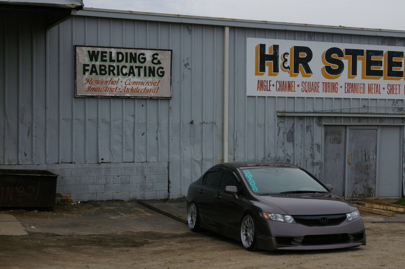

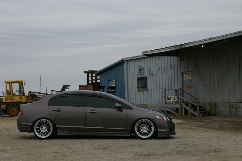

Will rota torque 18x9.5 +28 fit si sedan?
from stock to that -
inner clearance - 15mm less
outer clearance - EXTEND an extra 49mm
2012 Civic SI wheel: 5 x 114.3 bolt pattern, 17 x 7 offset 45mm
http://www.1010tires.com/wheeloffsetcalculator.asp
an 8th gen setup -
Ingalls Front camber bolts
Ingalls Rear camber kit
Enkei Nt03+M 18x9.5 +27 w/ a 5mm spacer because of clearance issues.
Federals 215/35/18
Buddy Club N+
