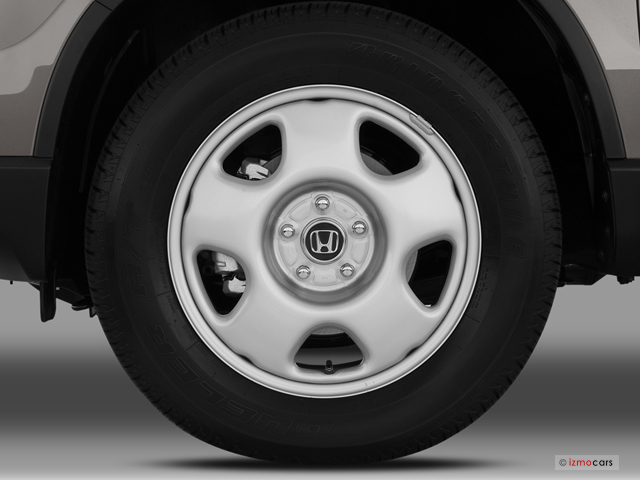

looking around some used ads this summer, if a good set of winters comes up, i figure ill grab em now and save some big money over buying in the fall.
I stumbled across a set of 205/50/17 tires, no issues with sizing there, but the rims are off a CRV, are the regular dull alloy 17s. does anyone know what the offset on these guys is, and if it would clear my Si's brakes?
thanks ahead of time for help, hopefully it helps others out as well.
pretty sure they 05-06, but they look exactly like these.
the 1997-2006 crv's had a +55 offset.
07+ went to a +40 offset.
Check and see what year they are cause I don't think the +55 will work out well.
