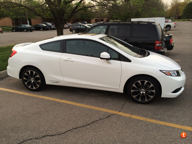

So, I really want to get some goodies for my car to get a little more out of it, but I'm just not able to drop more then like $400 right now. A real down pipe is out because I can't afford flash pro now, no catback because I don't want to get loud yet. I was thinking I could get a DC Sports Sri and a Tusdo testpipe for about $375 shipped and that would keep me happy for abit(then sell them when I had cash for better stuff). Are there better options for about the same price range? Any cel's would also be a no go for me.
Here's a random pic for your enjoyment.
