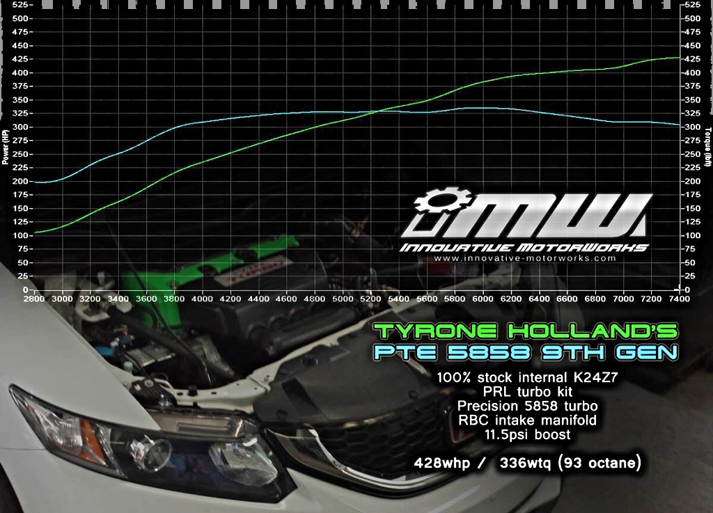

Well my car hit the dyno at innovative MotorWorks yesterday! Derek is the man!
Also some work was done as well
Hasport motor mounts 88a stiffness
AFR gauge
Turbo blanket
Iat sensor
Retune
Im completely happy with the outcome!
As you can see the car made an amazing 428whp 336wtq at 7400 with zero knock count and on 11.5 psi! I can officially say that Betty white is finally completed in the power department! I have not drove the car yet it's still in pa at IMW Saturday you guys will get videos and more pic!
