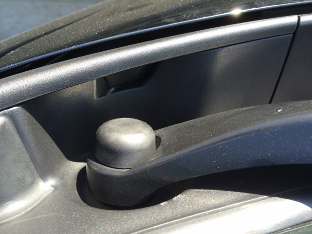

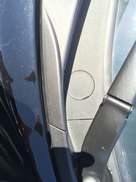

Do you think i took the valve cover off without removing the entire cowl?
You do NOT have to take the wipers off in order to remove a cowl on this car, or the 8th gen. plain and simple. you're mistaken
I disagree. unless you do a DIY and show me.

the cowl breaks away at these to points, leaving the piece around the wipers. the wipers don't need to come off.

What's the problem. It takes like 2 seconds to take the wipers off anyways. If you want to leave them on then go ahead. Everyone that has done this by themselves ghas taken them off
austin1636
199
157
Gresham
civic si
sedan
you could take all the wheels off before the install too.
obviously you can take them off, and it isn't THAT big of a step, but if you don't need to do it why do it? why bother taping off where and going through the hassle.
The DIY says that you have to take them off, and that just isn't true, so i was pointing it out.
