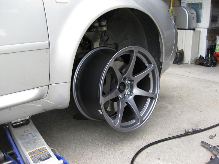

Word of warning to the OP - if your heart is set on those wheels, be aware that they will poke out A LOT, not just a bit. If you add any lowering of any kind, budget for some bodywork or you'll be rubbing like crazy (and even that might not be enough). Count on excessive wear on suspension components with what you are proposing to do.
And this is for a daily driver? I'd really advise that you reconsider your plans.

Just googled an example -- YIKES
Yeah, my bad @ElDiabloBlanco , these guys will stick out quite a bit apparently. These are some also ET15's on some Audi.
