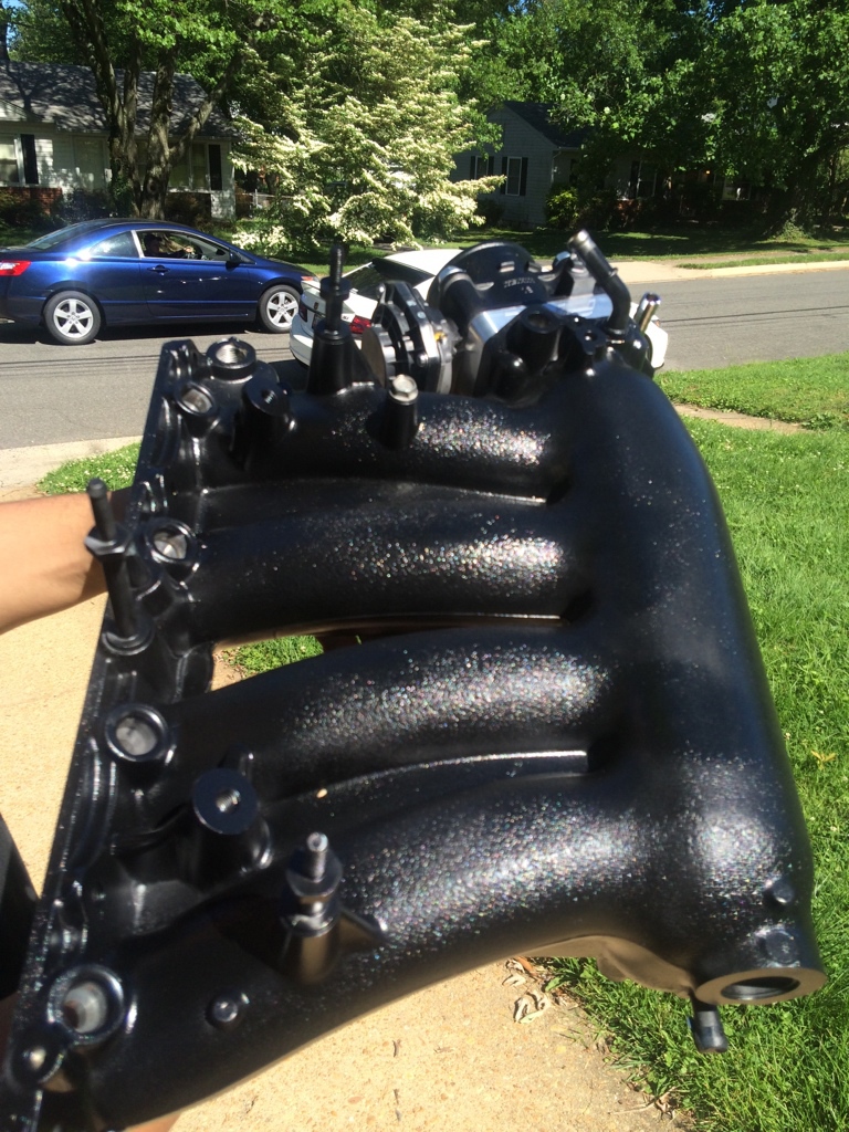

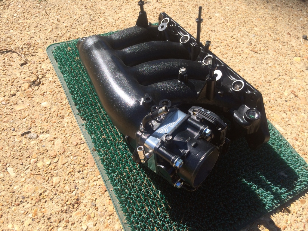

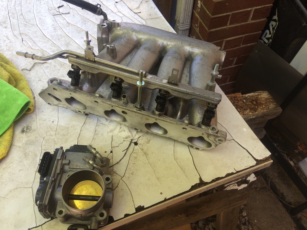

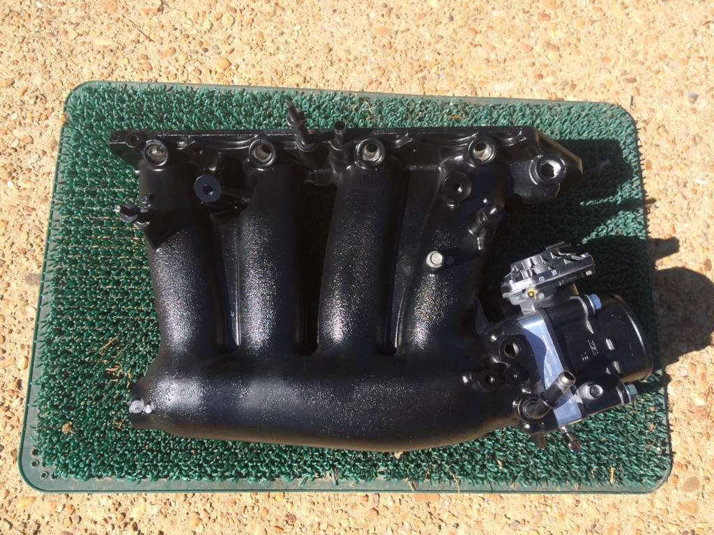

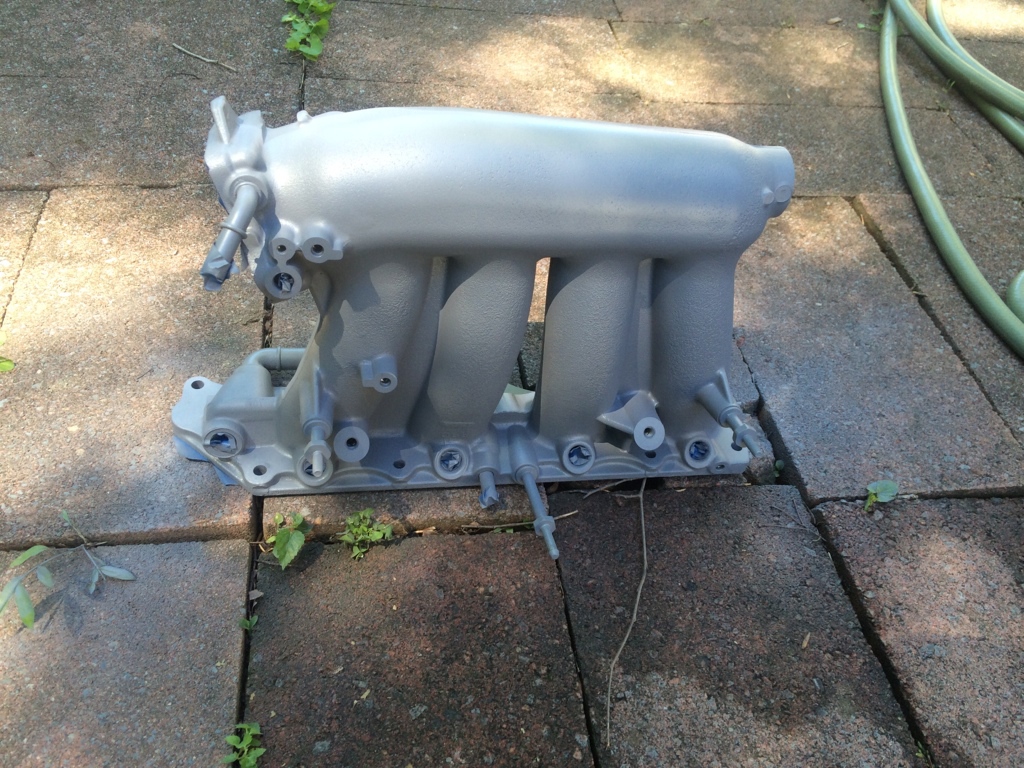

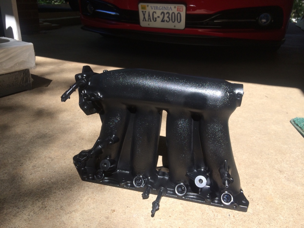

Well parts are starting to come in! Finally got my RBC manifold cleaned it up, sanded it down with 325 grit, 400 grit, 800 grit and lastly 2000 grit it was actually beginning to become polished so then we primed it with 3 coats and then 4 coats of VHT high temp satin black paint.... Did the same with throttle body. Came out amazing!

Wow. Looks great! Looks like the one I prepared over the winter with VHT wrinkle black, but haven't installed, because of the RBC Torque Dip Controversy.

Well I have seen gains from across the board with the rbc on different 9thgens some made more torque some made less in my case I'm going turbo so there shall be no lose in torque for me! Haha. But you manifold looks great! Hey twin!
